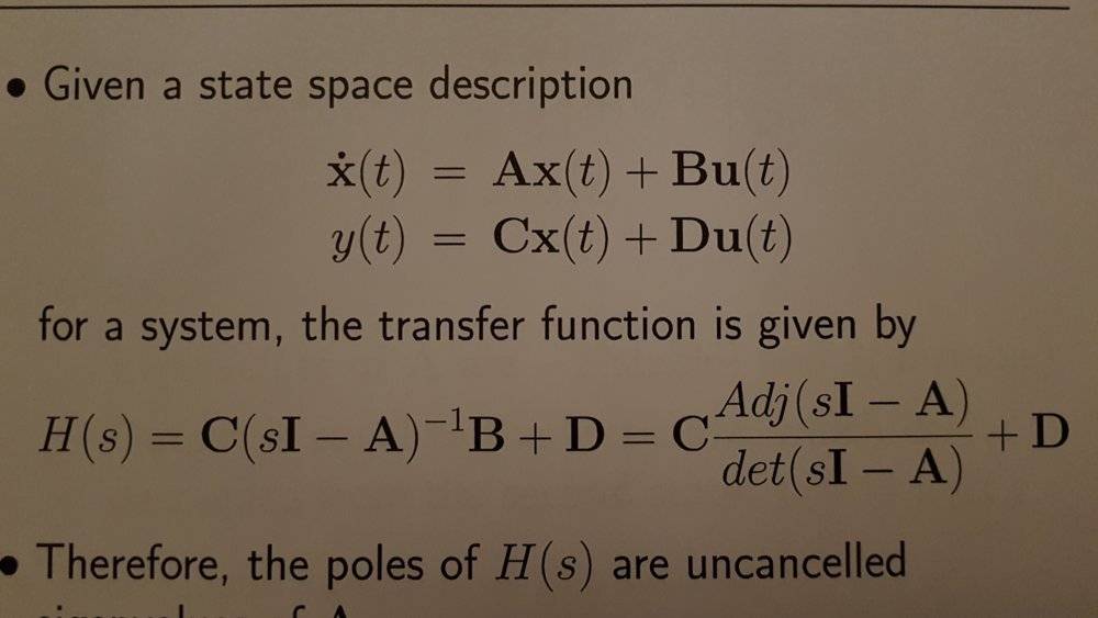

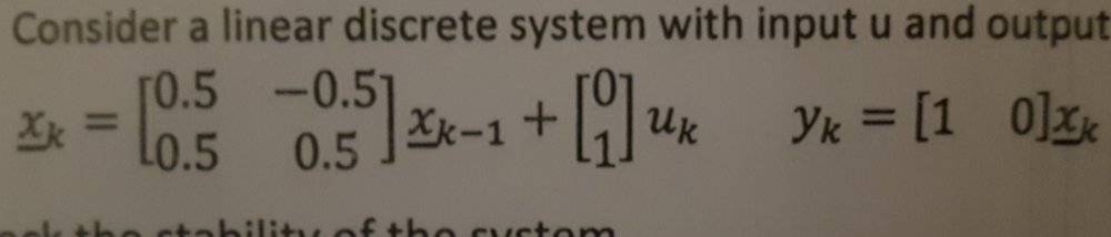

x'= [matrix values]x +[vector values]u
and solving the question
x(k)=[matrix values]x(k-1) + [vector values]u
Transfer function= c*[SI-A]^-1*B
I mean the first question has derivative form and the second is linear form so what the difference here in steps of converting both to transfer function... please need some ellaboration to make sure i am solving correctly or not... is it correct to apply the same rule on both:
And when do we need to use laplace ?
Laplace transforms are used (mostly) for continuous time systems.
Have you studied z-transforms yet?
Likes Std
Thx for the reply... actually i am studying it from online resources and what i found for both cases are
246631
246632
So i cannot tell the difference between steps of both linear and continous... they seem similar to me... and no laplace is used in those steps and that is what is confusing me ... so is there laplace in any step that i missed here? Thanks again 4 ur help
For example do these two questions have same steps of getting their transfer functions
246635
246636
I mean what i did for both is getting
Transfer fun= C*[SI-A]-1*B
Am i correct?
