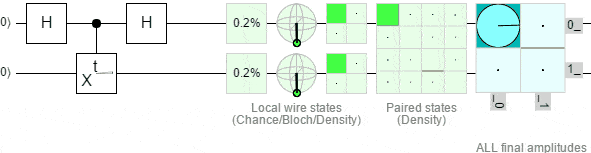

With qubits this situation is relatively simple. The interaction is a controlled operation, and its strength is related to the amount of rotation that operation causes (with a maximum at 180 degrees).
Here's a circuit diagram showing what happens as the amount of controlled rotation is varied between two Hadamard gates:
When the rotation is small (yellow spinner on X^t is near the right), the top qubit is staying coherent and most of the amplitude ends up back in the 00 state due to destructive interference. When the rotation is large (yellow spinner on X^t is near the left), the two qubits end up entangled and evenly split between the 00, 01, 10, and 11 states (and their individual marginal states are maximally mixed).
The gaussian case will be more involved, and I don't have the physics knowledge to compute it, but it should display those same basic features. As the interaction strength increases, destructive interference goes away.

What is the matrix model of your gate? Can it be used in this case to describe The interaction?
It is obvious that when we increase the number of air molecules ti becomes harder to get recoherence. As you propose to associate a logical gate to a molecule, is there a way (serial or, parallel) to associate them?
