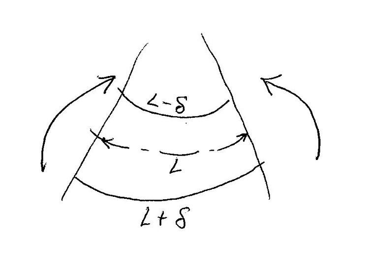

Inflatable SUP boards, LEI kites, Inflatable kayaks, and so on get their stiffness by having two layers of airtight materials separated by pressurized air. And it gets stiffer the higher pressure you can contain, or by increasing the separation between the materials. The simplest way to look at this is probably with the flat structure of inflatable SUP boards that is constructed by two airtight membranes and "drop stitching" between to maintain the flat shape.
But how can you calculate the stiffness of the board based on pressure and layer separation?
Likes Twigg and Lnewqban
Compressive stiffness. When local pressure, such as from your foot standing on it, exceeds the internal pressure, it will deform.
Bending stiffness. The top and bottom sheets have separation and stiffness. The material stiffness has units of strain per force/unit width. Multiply by the width to get sheet stiffness in strain per total force.
The board / kite / whatever has a bending moment distribution that can be calculated. The bending moment at any location results in tensile and compressive stresses in the sheets. Those tensile and compressive stresses are added to the tensile stress from the inflation pressure. The calculation is a little simpler if you neglect the internal pressure, and assume simple tensile and compressive stress. The sketch below shows the top sheet, neutral axis, and bottom sheet with a bending moment. Internal pressure is ignored. The neutal axis has a length L. The bottom sheet has a tensile force, therefore a positive strain, and a length L + ##\delta##. The top sheet has a compressive force, therefore a negative strain, and a length L - ##\delta##. The bending radius can be calculated from the strains and the sheet separation. Any basic strength of materials book has a very similar analysis, in greater detail, in the chapter on bending of beams.
You cannot. The pressure decides the point where it will buckle. If the skin tension falls below zero it will collapse. Once the collapse begins, that is another game, and all bets are off.
With sufficient internal pressure, only the fabric surfaces will be important in determining the small deflections due to small loads. The length of the skin surface will change to be longer or shorter as the loads change. You must model the elasticity of the vessel as a whole, as two separated elastic skins.

Crinkles will form if the surface ceases to be under tension. That is a form of surface buckling.
I think you are misinterpreting the term “stiffness”. Stiffness is a measure of the relation between small forces and small deflections of a structure. When bending a double skin structure, the length of the inner skin is shortened by the same proportion as the outer skin is lengthened. That holds until a crinkle forms on the inner skin when tension is no longer positive.
Until you accept the boundary between the structure deflecting and the structure buckling, you will be unable to analyse the system. Two separate models must be used.
Likes jrmichler

Are you trying to calculate the point of buckling collapse, or the stiffness of the inflated structure? As the internal pressure is increased, the load at which buckling collapse occurs is increased.
Stiffness is not a function of internal pressure. It is a function of materials and structure.
