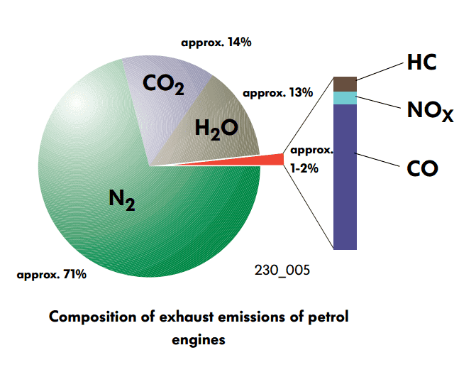

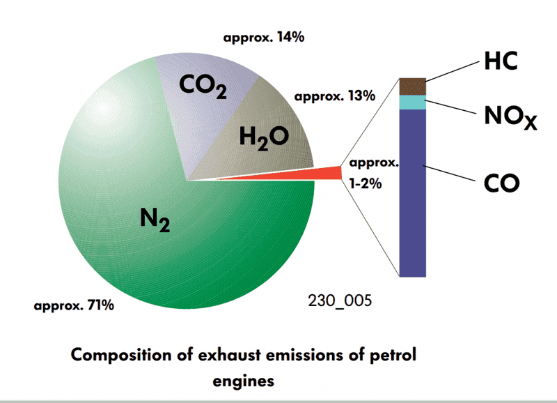

I think you may be overestimating the amount of unburned gasoline being exhausted, do you have any publications or references which quantify how much gas is leftover after the combustion cycle?
http://www.explainthatstuff.com/catalyticconverters.html
Typically, there are two different catalysts in a catalytic converter:
  • One of them tackles nitrogen oxide pollution using a chemical reaction called reduction (removing oxygen). This breaks up nitrogen oxides into nitrogen and oxygen gases (which are harmless, because they already exist in the air around us).
  • The other catalyst works by an opposite chemical process called oxidation (adding oxygen) and turns carbon monoxide into carbon dioxide. Another oxidation reaction turns unburned hydrocarbons in the exhaust into carbon dioxide and water.
Likes Work Hard Play Hard, RogueOne and jack action

None of those references specify the percentage of unburned fuel which is exhausted as a result of incomplete combustion. Try again.
I agree that overall combustion engines have relatively low efficiency, but the #1 loss is heat loss (radiator & exhaust), not unburned fuel.

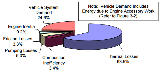

The main efficiency loss for an internal combustion engine is heat loss through the radiator and exhaust (approximately 60%). I have have provided references corroborating this fact.
Additionally, the provided reference shows that unavoidable combustion inefficiency losses account for about a 3.4% reduction in overall efficiency. This means that based on this paper your system can AT BEST provide a 3.4% increase in efficiency.
Baglione said:
Unavoidable combustion inefficiency losses occur since not all of chemical energy supplied is released during the combustion process. Incomplete combustion products in the exhaust representing chemical energy not released during combustion accounted for 3.4% of the total fuel energy losses.

Irrelevant, we are addressing your specific assertion that you can achieve large efficiency gains in a gasoline engine by vaporizing the gasoline into gaseous form before combusting.

Mike, Mech_Engineer is completely right. I will say that most of the time, only about 1% - 2% of fuel goes unburned in an engine (this is covered in Heywood's book "Internal Combustion Engine Fundamentals"). So any effort someone makes to improve efficiency by "burning all that unburned fuel in the exhaust" would only improve gas mileage from say, 20 mpg to 20.4 mpg - even if you could do it!
Carbureted engines aren't as efficient as today's fuel-injected ones, but (combustion-wise) it's mostly because carburetors don't accurately feed the right total amount of fuel per amount of air over the wide range of operating conditions engines experience. Intake manifold heating does a good job of vaporizing the liquid fuel before it gets to the cylinder (once the engine is warm), but at the expense of a hot mixture that is less dense, and so it will produce less power.

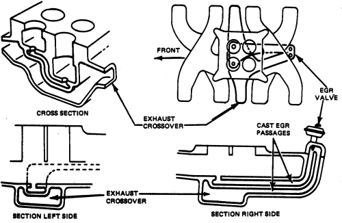

Michael Vannozzi said:
I am using a stainless steel Shell & Tube Heat Exchanger, (3" X 14"), and I have plumbed exhaust tubes into the shell sides, with the system having it's own independent exhaust system. I am using a motorcycle carburetor to supply air and fuel. The Air/Fuel mixture flows through the 30 straight tubes, and then through a 2.5" 90,(elbow), into the Open Plenum Edelbrock intake manifold.
This doesn't seem to vastly differ from a design of an exhaust crossover where a chamber is filled with exhaust gases to create a hot spot to improve fuel vaporization in the intake manifold passages (HINT: Racers block these passages to improve performance of their engines).

In your 2nd reference, it is written:
Engine Losses: 68% - 72%
thermal, such as radiator, exhaust heat, etc. (58% - 62%)
combustion (3%)
pumping (4%)
friction (3%)
Doesn't it say that only 3% is lost because of combustion? A number similar to what @Mech_Engineer presented (3.4%)?
When they say «exhaust heat» loss, doesn't «heat» implies that the fuel was already burnt?
I'm only saying this because in your 3rd reference, there is a link (Click[/PLAIN] here for a diagram of power losses.) where they show the following image:
The 6% friction loss is clearly not related to combustion, but the rest is lost through «water heating» and «exhaust heat». Clearly, «water heating» means that the fuel has burnt and heated up the coolant, as it is impossible that unburnt fuel has escaped through the cooling system. Why would «exhaust heat» mean a different thing?
