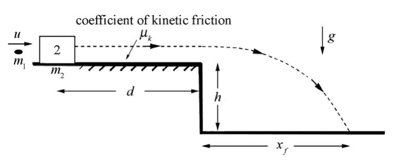

A bullet of mass ##m_1## traveling horizontally with speed ##u## hits a block of mass ##m_2## that is originally at rest and becomes embedded in the block. After the collision, the block slides horizontally a distance ##d## on a surface with friction, and then falls off the surface at a height ##h## as shown. The coefficient of kinetic friction between the block and the surface is ##\mu_k##. Assume the collision is nearly instantaneous and all distances are large compared to the size of the block. Neglect air resistance.
(a) What is ##u_{min}##, the minimum speed of the bullet so that the block falls off the surface? Express your answer in terms of some or all of the following: ##m_1, m_2, \mu_k, d, h## and ##g## for the gravitational constant.
(b) Assume that the initial speed of the bullet ##u## is large enough for the block to fall off the surface. Calculate ##x_f## , the position where the block hits the ground measured from the bottom edge of the surface. Express your answer in terms of some or all of the following: ##m_1, m_2, \mu_k, u, d, h## and ##g##.

Can someone check please?

Looks right.
@haruspex Thanks for checking.
This is a sketch of what I've done:
(a)
##t=t_1:\text{right before the collision}##
$$\overrightarrow{p_1}=m_1\overrightarrow{u}$$
##t=t_2:\text{right after the collision}##
$$\overrightarrow{p_2}=(m_1+m_2)\overrightarrow{v_2}$$
Conservation of momentum to find ##v_2##:
$$\overrightarrow{p_1}=\overrightarrow{p_2}\Rightarrow v_2=\frac{m_1}{m_1+m_2}u$$
Newton's 2nd law to find acceleration:
$$\overrightarrow{F}=m\overrightarrow{a}\Rightarrow a=-\mu_k g$$
Considering the case when the block stops on the edge:
$$v^2=v_0^2+2a(x-x_0)\Rightarrow 0=v_2^2+2ad\Rightarrow u_{min}=\big(1+\frac{m_2}{m_1}\big)\sqrt{2\mu_k g d}$$
(b)
Applying the same logic to find horizontal component of falling speed and so ##x## as a function of ##t##:
$$v_x=\sqrt{\big(\frac{m_1}{m_1+m_2}u\big)^2-2\mu_k g d},~x=v_x t$$
Using kinematics to find ##y## as a function of ##t##:
$$y=h-\frac{1}{2}gt^2$$
Eliminating ##t## from both equations:
$$y=h-\frac{g}{2v_x^2}x^2$$
At ##y=0\Rightarrow x=x_f~:##
$$x_f=\sqrt{\frac{2h}{g}\Big(\big(\frac{m_1}{m_1+m_2}u\big)^2-2\mu_k g d\Big)}$$
