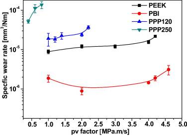

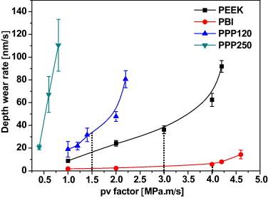

I made a mistake on my previous post (#12). The graph I posted was the one that shows depth wear rate as a function of PV. Graph repeated below for convenience:
http://ars.els-cdn.com/content/image/1-s2.0-S0043164811005916-gr2.jpg
This shows the “depth wear rate” for various materials given the PV. The amount of material lost to wear is the depth wear rate (units nm/s) on the Y axis shown in the graph times time. So if you know PV and the material, you go along the X axis of the graph and up to the material to find the depth wear rate. You can then multiply by time to get how much material is shed. What I was trying to point out is that as you double the PV (by say doubling P), the depth wear rate also doubles.
Also, I shouldn’t have shown K = PV as an equation, I meant to only point out that the rate of wear is proportional to PV. What I should have said is that there is a "specific wear rate" which is generally thought of as being a constant for a material up to a given point as shown in the graph below. If you multiply the specific wear rate times PV you should get the depth wear rate. These graphs are both taken from a paper I found online here.
It should be noted that the wear rate varies depending on the material (there are 4 different materials shown in that graph) but also due to surface roughness and hardness, temperature, any gasses or fluids in contact, etc… so it is an emperically determined value. Note also that the graphs are for various polymers and they're being used only as an example, but brake pads will have similar wear characteristics.
To get back to the OP, the point I was trying to make was that
- The rate at which material is shed from a brake pad is linearly proportional to PV. If you double the PV, the rate at which material is shed is doubled.
- The rate at which a car decelerates is also linearly proportional to the PV of the brake pad.
- If you increase PV above some point, wear rate can be greater than linearly proportional which can happen for example if the temperature goes up. (consider for example, the point you (Simon) raised earlier (post #2) about the amount of energy that has to be absorbed by the brakes in order to stop the vehicle)
Given those factors, it should be fairly clear whether or not brake pad wear will increase, decrease or stay the same under various conditions.
Sorry for the confusion.

This introduction of real-World data appears to have strongly answered the original question.

The graphs seem to show that we'd expect very high PV braking for short duration to potentially produce more wear (ceteris paribus) than low PV braking for a longer duration.

This lesson/observation is supported by the graphs - the graphs also give you an idea of how quick "quickly" is to get higher brake wear.
