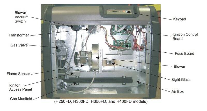

So I bought a Hayward 250000BTU gas pool heater for my pool, and installed it outside, as per recommendations from pool company and installer. Problem is it produces a low frequency rumble due to the fan-blown air being ignited . The previous pool heater was way quieter as it used "atmospheric draft" to draw air - apparently the fans are used on pool heaters to increase efficiency.
Neighbors are NOT HAPPY - they keep telling me they hear the low rumble in bedroom, office and all around their backyard. I paid $1200 to move it 15 feet further from the 6 ft wooden fence between our properties. Not happy.
I put up another wood "fence" panel, 7ft high by 54 inches (using 1 by 6 inch boards on 2 by 4 s), 14 inches from the heater and between the heater and their property to screen/deflect the sound. Not happy.
I added another fence panel 90 degrees to the previous one to create a "V" shaped wall to try and deflect more sound, and I put in place two large bins worth of earth to build up the ground to try and add mass near the base of the heater's concrete pad. Still Not happy.
Help wanted! Advice wanted! Would adding another layer of plywood to each fence panel help? Foam bass traps?? Bushes? Or is there really no hope due to the low frequency?

Welcome, Hawthorne!
There should not be any reason for your fan to generate so much noise.
The design is not the best because the weight of the fan is hanging from a sheet metal casing that is poorly supported from a sheet metal body.
If the impeller of the fan is not properly balanced, the vibration will be amplified by the sheet metal surfaces, like a box of an acoustic guitar does.
I would close the gas shut-off valve, open the heater, and observe the fan while working.
Try supporting the motor a little better with something solid but non-combustible.
If you have some, place weights over, or attach some angle, to any vibrating panel that you see.
The above should at least change the frequency and intensity of the noise.
