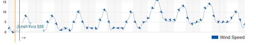

fog37 said:
I have heard that during some time of the day, like at night, wind turbines are not operated because there is low need of energy at that time of the day...Is that possibly true?
One of the reasons is that in locations like the wind farms near me (east of Silicon Valley, California), the wind typically dies down at night. Below is a plot of the wind velocity and direction for the next 10 days:
https://www.wunderground.com/foreca...7114,-121.80632767983757?cm_ven=localwx_10day
BTW, here in Northern California we have "rolling blackouts" that can happen on very hot days when lots of air conditioners are running. They typically take place between 5-`10PM, because the large solar farms start losing sunlight in the early evening, which reduces the available power for supplying all of that air conditioning while the air is still hot outside.
Likes fog37

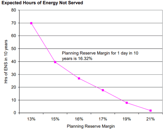

Everything you said is true Tom, but they are not valid excuses.
California's wildfire problem is severe. But the utility's response to red flag conditions is to shut things off in the red flag region until the weather changes. Rolling blackouts or brownouts that last a few hours are not because of fires, they are an attempt to remedy shortage of supply.
The difficulties you cite in California are analogous to the difficulties in every other state and other countries in the world. Difficulty is no excuse for breaking the law. "But officer, I was speeding because I'm late for work."
I am saying that California can meet and should meet FERC's and NERC's and CAISO requirements, even if they find the necessary steps distasteful. Other states with their own challenges do comply.
For those who don't know, here are the acronyms:
  • FERC = Federal Energy Regulatory Commission
  • NERC = North American Electric Reliability Corporation
  • CAISO = California Independent System Operator
Edit: and here is the curve that describes what I'm talking about.
https://www.xcelenergy.com/staticfi...SCo-ERP-2011/Attachment-2.10-1-LOLP-Study.pdf
Likes russ_watters
