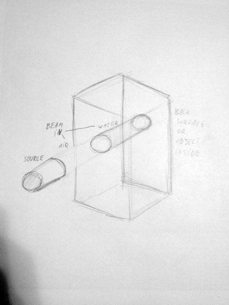

I want to achieve an effect of a regular beam of white light - light cylinder in slightly opaque water. Sort of similar effect to light diffusion in fog. I did some experiments with lenses but what I got was fuzzy edges and focused or spread beam. I suppose I would have to use some certain combination of lenses, or a light collimator. Could you help me with this?

Hmm, the Idea is that the light beam becomes clearly visible when it hits the side of the tank and continues as a visible cylinder until it hits a surface.
I'm afraid that I really don't quite understand what you mean. Is there some way that you can post a sketch? I find things like this easier with a visual description.:redface:
It may not be the best explanation, but it's almost 5am here ;P
Okay, I see what you mean now... I think. The beam is to be invisible in air, and become a solidly defined cylinder in the water? I'm afraid that it can't be done the way you want because white light is incoherent. You would need a laser, which has to be one distinct colour and would be far narrower than you desire.
The only thing that immediately comes to mind is that you could use a plexiglass rod that almost exactly matches the refractive index of the water so it can't be seen from outside the tank. If it's glued to the sides of the box, you could shine a high-intensity light (such as a slide projector) onto the wall from outside right at the junction point. Ideally, the rod would then capture that light and transmit it to the other end with enough leakage that it would glow. There's no need for me to sketch up what I mean, because it would look exactly like what you've already drawn. I really have no idea as to whether or not that will work, but it might be worth some small-scale experimentation.
