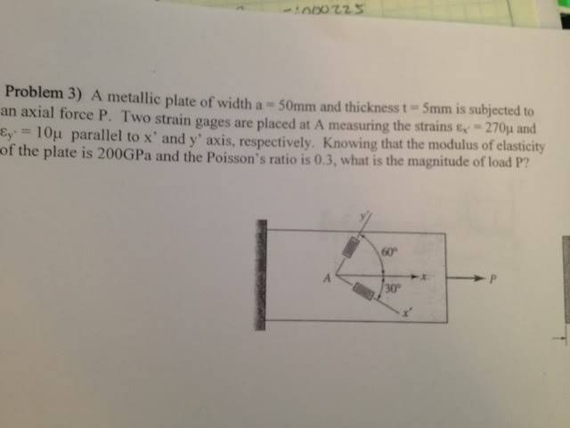

Strain Gauge Angle Homework question.

[a]1. Homework Statement [/b]
I thought it would be easier to post a picture since this way the drawing can be seen. I'm having a hard time deciding what angles to use with the relevant equations, see below.
I know that:
Ex' = (Ex/2)*(1+cos(2*theta))+(Ey/2)*(1-cos(2*theta))+(gammaxy/2)*sin(2*theta))
Ey' = (Ex/2)*(1-cos(2*theta))+(Ey/2)*(1+cos(2*theta))-(gammaxy/2)*sin(2*theta))
Gammax'y'= -Ex*sin(2*theta)+Ey*Sin(-60)+gammaxy*cos(2*theta))
Then, back solve for Ex, Ey, and gamm. Then use: Sigmaxx = (E/(1-v2))*Exx+ (v*E*Eyy)/(1-v2).
From There, Sigmax = P/A
I used -30 and 2theta = -60 for the angle in all three of the above equations. However, a friend used -30 for Ex, 60 for Ey, and 15 for gammaxy. What is the correct angle? I get 12.5KN as a final solution, while she gets 1.85KN.
I used a matrix:
Ex Ey Gammaxy = Ex' or Ey' or gammax'y' respectiveyl
.75 .25 -.433 = 270E-6
.25 .75 .433 = 10E-6
.866 -.866 .5 = 0
I find that: Ex = 250E-6 Ey=.75E-6 and gammaxy = -225E-6
I find that Sigma x = 50Mpa
and Finally P = 12.5 KN based on the above equations.
Did I make the correct assumption that I should use -30 as the angle for all three stress transformation equations? All help would be greatly appreciated. Thanks!
xXOfNiRXx: You are correct; use theta = -30 deg for all of your relevant equations. Your relevant equations are correct. However, your solution and answer are currently wrong. Try again. Also, do not round your numbers so much. Hint 1: You seem to have said gammax'y' is zero, and gammaxy is nonzero; but shouldn't these two be the other way around?
(1) By the way, always leave a space between a numeric value and its following unit symbol. E.g., 1.85 kN, not 1.85kN. See the international standard for writing units (ISO 31-0). Or see any credible textbook.
(2) The unit symbol for kiloNewton is kN, not KN. The unit symbol for megapascal is MPa, not Mpa. Always use correct capitalization of unit symbols.
(3) Numbers less than 1 must always have a zero before the decimal point. E.g., 0.25, not .25. See the above links.
Thank you for the feedback. I will correct my errors momentarily. Can you explain why gammax'y' is not zero and why gammaxy is zero?
xXOfNiRXx: In your relevant equations in post 1, you currently have three equations and four unknowns. You need one more equation. Hint 2: What is gammaxy for principal axes?
Alternately, you could use hint 3, instead of hint 2. Hint 3: What is an expression for eps_y, in terms of eps_x, using Poisson's ratio, when the y faces are unconstrained and not loaded, where eps means epsilon?
Got it, thanks for your help. :)
