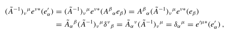

Thanks for the response! But I'm sorry @Ibix I couldn't follow - I think I did not frame my question very well. My doubt isn't why one index is up and the other is down - it's why the indices are staggered in that particular way. There are three paragraphs in my OP, first para I'm pretty sure about (though you can correct if I'm wrong). So that explains why indices are staggered the way they are in ##e'_j=A^i_{\ \ \ j}e_i##.
Regarding 2nd paragraph, that's a hand-wavy explanation I've cooked up that I'm not at all sure about. I don't even know why the transpose of ##A^i_{\ \ \ j}## is written as ##\tilde A^{\ \ \ i}_j##. See here (an excerpt from the book) for an example - 3rd equality first term:
And my question in the final paragraph still stands..
