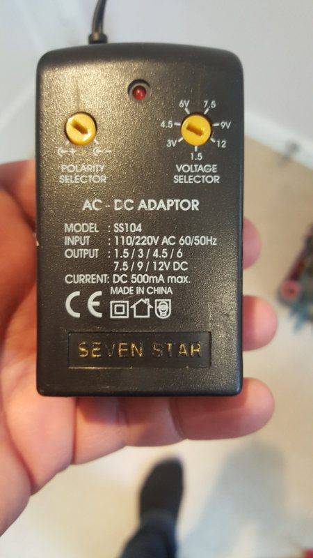

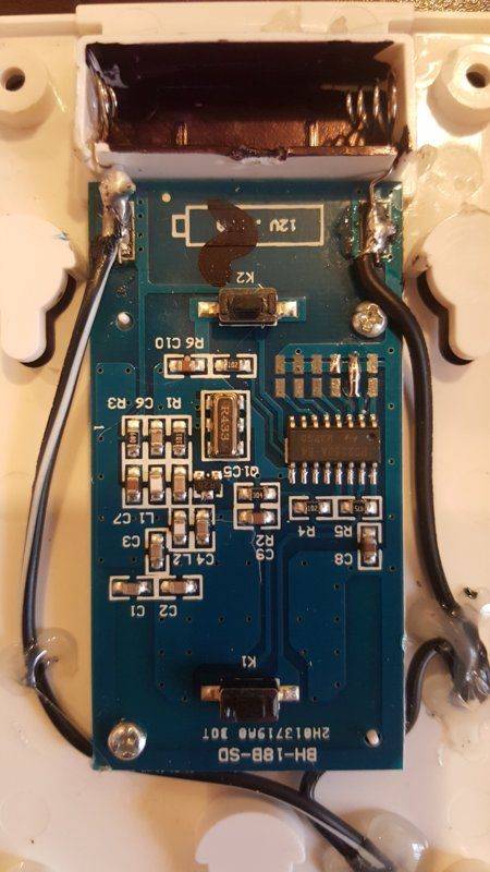

Hi everyone, I finally got some time to take a few pics of the transmitter and two of the power supplies I've used.

Hi Tom, I just checked the power supply I used most of the times in my test and indeed it's reading 17.8 volts when connected to the board. However the other power supply with the variable voltage power supply is tuned to supply ~12VDC to the board.
I have to go to the site where this unit needs to be installed to double check using the variable voltage power supply and then report back.

Sorry for the late report back. The Variable power supply didn't work either. We ended up buying a bunch of power supply units to see if anything would work and as it turns out only one did... the one with slightly less than 12VDC and 100 mA. Anything above 100 mA wouldn't work.
At any rate, I'm glad it's working - thank you all for your help!
