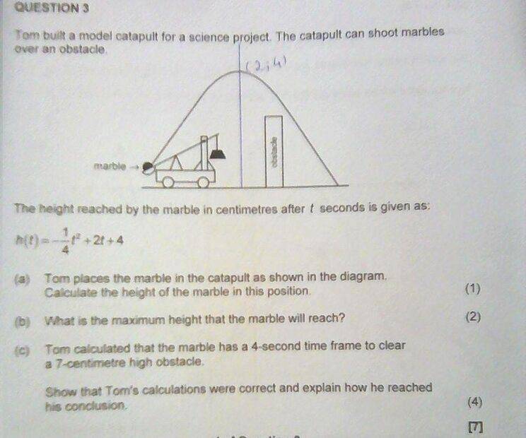

Am I seeing "gremlins" where there aren't any or is there something odd about this question ? In 3c), how can you calculate how long it takes to "clear" an obstacle if the width of the obstacle is not known? Nor the horizontal velocity of the projectile.

I am not sure how exactly to interpret (c), however when I solve the equation ##h(t)=7## I get two values for t, namely ##t_1=2## and ##t_2=6## and it is ##t_2-t_1=4## (equal to the 4-second time frame) .
It is also ##h(t)>7## for ##t_1<t<t_2##.
I guess by "time frame to clean an obstacle of height 7cm" it means the width of the time interval ##I## such that ##h(t)\geq 7## for every ##t\in I##.

Yes if they just asked something like "for what length of time is the marble above 7cm in height" it would be fine. But the picture of an apparently thin object and wording "time frame to clear" just don't make any physical sense.

The problem for Tom was that he was not advised how thick the obstacle was. Perhaps it was the thinnest of thin plates. Then as long as it was appropriately placed such that the catapaulted marble was above 7cm by the time it 'reached' the plate, it would clear it in an undefined trice ! Tom's calculation is based on the premise that the obstacle is 7cm high and exactly 4 seconds "wide" at whatever unspecified horizontal velocity the marble was fired at. But personally I very much doubt that Tom's creator gave that a moment's thought!

That's not how I read the problem. Tom is given a formula and a 7-cm high barrier. There is no language in the problem that says that the barrier is exactly 4 s wide. Rather, Tom has done the calculation and claims that, as long as the barrier is less than 4 s wide, a distance to it can always be found such that the marble will clear the obstacle. We are asked to substantiate this claim. Furthermore, the accompanying figure shows that, at barrier height, the parabolic trajectory is several times as wide as the barrier.

No gremlins. Tom can even calculate the maximum width of the obstacle that will allow an uninterrupted flyover and the horizontal distance from the wall where the marble should start.
The given equation ##h(t) = -\frac{1}{4}t^2+2t+4## implies ##h_0=4## cm, ##v_{0y}=2## cm/s and ##g=\frac{1}{2}## cm/s2. The units are specified in the problem therefore we must conclude that Tom is not near the Earth's surface.
This says that in the 2 s the marble rises to the height of 7 cm, its vertical velocity is reduced from 2 cm/s to 1 cm/s. At that point, to maximize the horizontal range, the local projection angle must be 45o. This means that ##v_{0x}=1## cm/s which means that the maximum width must be 4 cm and that the marble must be shot from a distance of 2 cm from the obstacle. The initial projection angle is ##\theta=\arctan(\frac{2}{1})=## 63.4o.

All good but re the "gremlin" , let me pose my original question slightly differently.
Suppose the obstacle were 1mm thick. Would the marble still require a 4 second time frame to clear said obstacle ? I think the "gremlin" is in one's interpretation of "time frame to clear" which could arguably refer to the time it takes the marble to move across the article rather than the entire time frame for which the marble's height is above 7cm.

The problem might not seem clearly stated but I think that may be either intentional and the reason for the "explain how he reached his solution" bit.
I initially assumed I was looking for the total time to return to 7cm of height but when the quadratic gave answers 4s apart, realized that's what he had done.
Whatever the thickness of the barrier (or the horizontal cmpt of velocity), the marble has 4 seconds when it can clear that height.
