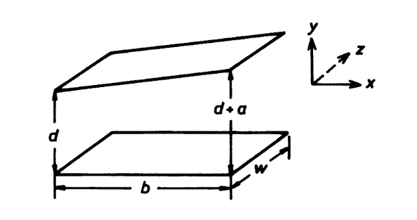

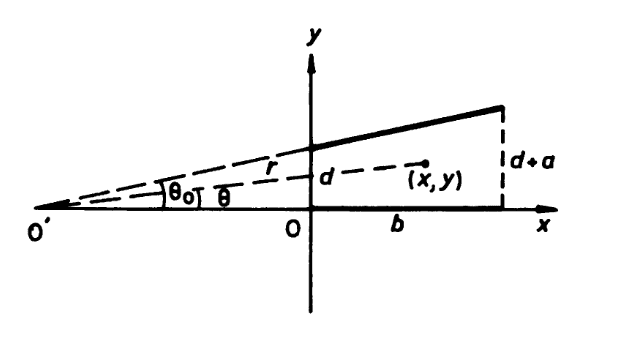

Working along step-by-step with a text and I'm stumped as to how they reached a conclusion. In the first picture you see two plates aligned at an unspecified angle, theta. One plate is at a potential V and the other is grounded. The distance between the plates at one end is d, and at the other end d+a. You can see in the second picture how they've set it up with respect to a two dimensional coordinate system. Maybe it's late and I'm braindead or maybe not in any even I can't see how they've formed the relationship between b,d and a to determine the distance between the actual origin and the intersection of the plates (dotted lines in picture three). Can anybody enlighten me?
Thanks.
P.S. the whole point is to find the potential, but this is where I'm hung up.
In the triangle (in x<0) with base OO' and the height d, you have
tan(theta_0)=d/(OO').
In the trapezoid (in x>0), draw the horizontal at height d to form a similar triangle,
with base b and height a. Thus
tan(theta_0)=a/b.
Truly geometry is my weakest link. Thank you.
