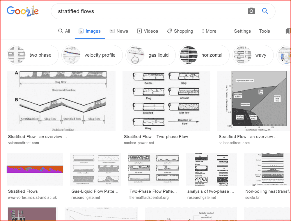

What are the meaning of the term "Stratified Flows " physically?
Google (Images) is your friend...math04 said:What are the meaning of the term "Stratified Flows " physically?
A stratified flow is a type of fluid flow in which there are distinct layers of different densities. This can occur in both liquids and gases, and is often caused by a combination of gravity and differences in temperature or salinity.
The physical meaning of stratified flow is that it is a result of the interaction between gravity and density differences in a fluid. This can have important implications for various natural phenomena, such as ocean currents, atmospheric circulation, and river flows.
Some examples of stratified flows include ocean currents, atmospheric layers, and river flows. In these cases, the density differences are caused by differences in temperature, salinity, or other factors.
The effects of stratified flows can vary depending on the specific situation. In some cases, they can lead to more stable and predictable flows, while in others they can cause turbulence and mixing. They can also have important impacts on the transport of heat, nutrients, and pollutants in natural systems.
Scientists study stratified flows using a combination of theoretical models, laboratory experiments, and field observations. They may also use specialized instruments, such as probes and sensors, to measure the density and velocity of the different layers in a stratified flow.
