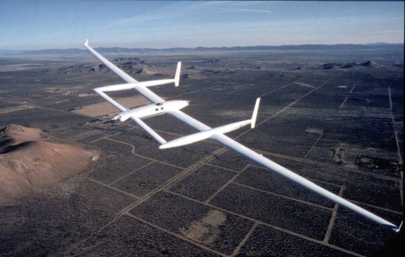

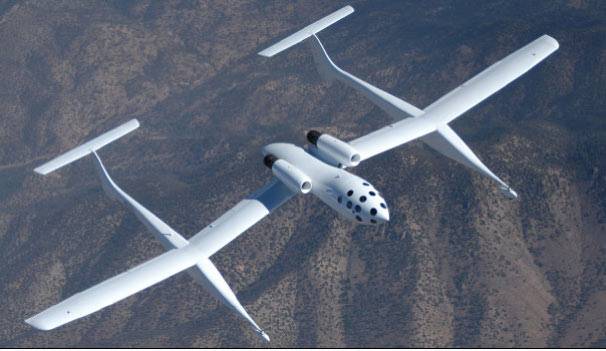

Twin-fuselage aircraft aren't very new, although this would be the biggest one ever made. See here: https://en.wikipedia.org/wiki/Twin-fuselage_aircraft

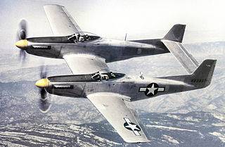

I did say my guess %^) The inner wing does not look too strong compared to the size of the fuselages. I would have at least joined the rear elevators like the twin Mustang (turbulence from the payload might nix that idea, then just raise the elevator). That would have eliminated one vibrational mode and reduced another? The anticipated stress on that inner wing must be crazy?
