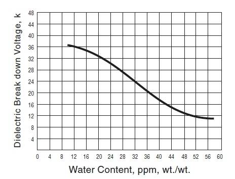

Unless you have run a test on a fresh sample there is no way of knowing, and it's not amenable to gut feelings. Mineral oils absorb atmospheric moisture - not very much, but it doesn't take much to mess with dielectric fluids. For instance, unused oil in sealed, full drums has been known to fail dielectric testing if stored in a location with significant daily temperature variations for a prolonged time due to moisture getting past bung seals as the drums expand and contract.
This graph is from "Understanding Water in Transformer Systems" by Lance Lewand of Doble Engineering, and uses the ASTM D1816 test protocol with a 0.04" (1mm) gap. As you can see, it doesn't take much dissolved water to appreciably depress dielectric breakdown voltage.
Even though the focus is on their test equipment line it's worth reading "The Megger(TM) Guide to Insulating Oil Dielectric Breakdown Testing" to gain a sense of how meticulous dielectric oil testing is.
