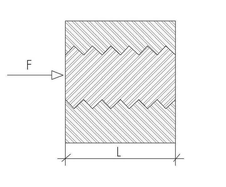

Hey, I'm trying to learn a bit about the strength of threads in bolts and have a couple of questions.
Let's say I have a system that looks something like this:
I want to find out if there are enough threads to withstand the force F.
The nut and bolt material are not the same.
I have done some research and found out that ANSI has a couple of equations for this type of analysis.
First we have the Shear Area of External Threads :
A_s,e = pi*n*L_e*K_nmax*[1/2n + 1/sqrt3*(E_s,min-K_nmax)]

I really don't understand this equation. This is supposed to be the area where shear will occur right? How is it that they use the length of engagement to get that area?
Can I divide the force F with this area and compare the results with the shear strength of the material?
I know, a lot of questions, hope someone can give me some hints.
Thank you
The term (K_nmax*[1/2n + 1/sqrt3*(E_s,min-K_nmax)]) would be the effective diameter per unit length of engagement.
So the engagement area would be effective circumference * L_e, where effective circumference = pi * effective diameter. The location of maximum shear is not necessarily at the base of the thread, and is not necessarily parallel with the axis of the bore.
I think that if the nut material is stronger than the material from which the bolt is made, the threads will strip at the roots of the bolt teeth. Doesn't that mean that the location of maximum shear will be at the base of the thread?

That's the standard for calculating the stripping of a thread form. The reason the length of engagement is involved is because the longer the thread engagement, the more stripping area is created. Imagine you are calculating the area of compound circles. Each thread is a circle and each thread's circle adds to the overall stripping area. This is why, in tables, thread stripping areas are tabulated for a length of engagement equal to the nominal diameter of the thread. If you think about it, this makes perfect sense. If the length of engagement were not involved, why would we need different lengths of bolts?
It depends. If you get the area from a table that lists them, as I just mentioned, that area is based on a length of engagement equal to one diameter of the thread.
The nut has a tensile yield strength of 515Mpa while the bolt has a Tensile ultimate strength of 345Mpa.
I used the equation with a length of engagement a bit larger than the nominal diameter of the thread. I got A_ts=970mm^2.
Then the force required to strip (shear) the thread of a bolt or nut:
F=S_u*A_ts where S_u=ultimate shear strength of the nut or bolt material
The bolt is made of Titanium Grade 2 and I don't know its ultimate shear strength. What I do is say that the ultimate shear strength is 0.6*yield strength, just to be on the safe side. Is this alright?
I get a force much larger than the force that is going to be applied to the bolt. Would this be proof enough that the bolt and nut will hold?

The 60% for shear is good for ductile materials. I would have to go back into my references to see if that holds for Ti. Come to think of it, you don't need the shear strength. Use the ultimate tensile of the material for your calculations. That is what is done in the literature.
You're on the right track. The thing about fasteners is that they can be infinitely complicated if you so choose. They seem very simple but they really are not. The calculation you have done is a good start. To do a full fastener analysis, you need to look at the possible shear loads on the bolts, the preload applied and the possibility of an induced bending moment in the fasteners.
If you want to be absolutely certain about your fasteners, make sure you have a good factor of safety built in, like FS=3 on yield. That will be very conservative.

The thing usually looked at is the tensile failure of the shank itself. If you really want to try to calculate the thread stripping (which should happen AFTER the shank fails in a proper design) you would indeed look at the shear strength. I just always assume one is talking about the tensile failure. Sorry for the confusion.
I would be careful with neglecting preload. I have no idea what your joint or loading looks like so it's your call. Usually preload is specified around 70% of yield in a standard situation.

That tensile area is the tensile area of the shank. If you run the numbers between the two methods, the area should come out to be equal. I have a spreadsheet that does this for a few methods and the fasteners I have looked at this is the case. There may be some that are slightly different, but they are going to be very close.
The force on the bolt isn't really needed in these calculations. It all comes down to the areas involved until you get to the failure theory of things in which case you do need the force.
Jaap,
Even if you do have the required length of engagement, the load is never evenly distributed over all of the threads. The rule of thumb is that the first 4 threads take a good portion of the loading.
I would highly receommend that you get a copy of Bickford's Introduction to the Design and Behavior of Bolted Joints. It does a very good job of explaining and showing just how very difficult fastener design and analysis can be.
