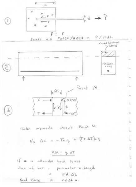

Back to reinforced concrete, consider a steel bar, partly embedded in a block of concrete.
It will take a force, P, pulling on the bar to pull it out from the concrete.
I have shown this in sketch 1
The only forces acting are the pull, P and the 'frictional' grip force, F.
Since we want standardisation we measure this in terms of a pull out contact stress, u.
This stress (as all stresses) is a force divided by an area.
Unlike friction in normal mechanics this force is proportional to contact area.
The contact area is the embedded length times the bar perimeter as shown.
The pull out bond stress, u is a measured parameter. There is no magic crystal lattice theory to derive it. Safe values are given in design codes, as a result of many years of experience (measurements).
This is analagous to hold the bar (or your finger) in a pair of pliers and pulling.
So how do we use this information in a structure?
In sketch 2 I have show a very simple beam with a single reinforcement bar in the bottom.
It should be noted that the neutral axis is not midway up the section in such a beam. I have shown it dashed.
All the concrete above the neutral axis is available to resist the horizontal compressive stress, brought about by the beam loads.
For simplicity we assume that all the tensile stresses developed below the neutral axis are resisted by the reinforcement.
In sketch 3 I have taken a typical vertical section, somewhere along the beam.
In order to perform mechanical calculations, stresses have been converted to stress resultant forces. So the compressive stress resultant shown is actually the resultant of the compressive stress over the whole area of the compression zone.
As shown we take a moment balance about the point M, for the forces acting on our block of length [tex]\Delta[/tex]L.
Now the net force acting within the bar, over the length [tex]\Delta[/tex]L is [tex]\Delta[/tex]T.
This is the value of the force P trying to pull out the bar from the concrete as in sketch 1above.
This yields two equations.
[tex]\begin{array}{l}
V\Delta L = q\Delta T \\
\Delta T = u\pi d\Delta L \\
\end{array}[/tex]
A bit of shuffling with these leads to the leads to the requirement
[tex]\frac{V}{{q\pi d}} \le u[/tex]
Now u is a measured quantity and V is the vertical shear at the section, as calculated by normal mechanics of loads.
This is exactly the condition that has to be satisfied when designing rc structures.
In fact rather than use the stress parameter u, it is more usual to quote the
bond length. This is the length of bar that needs to be embedded to fully resist a pull out force equal to the strength of the bar (ie the max force allowable in the bar).
Codes quote bond lengths for different types of bar, a good rule of thumb is 20 times the diameter.

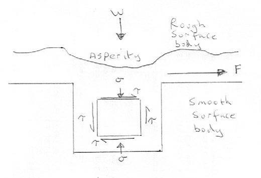

Studiot,
Do excuse me if I've mistaken and misunderstood your intent behind the statement regarding ME previously. I regret my reaction sincerely.
Regarding the reinforced structure
1) Concrete exerts a triaxial compressive stress on the reinforcement embedded in it. It is this stress that is the source of the grip. It is purely mechanical.
2) The term bond is used by civil and structural engineers to refer to this grip. This bond is not chemical and has no relation to the interatomic forces. Concrete does not chemically interact with steel, except insofar as it passivates the steel against corrosion.
Yes I can understand that the concrete and steel would not react chemically, but ultimately any force exerted between two bodies ( even of different materials - as is the case here) should have the electrostatic forces acting between their atoms ( and due to the close proximity exsisting between them) as the only source for the origin.
This can be compared to the Force of Friction between two bodies ( of different materials) which is built up only due to the interatomic ( don't confuse it with chemical reaction -- typical chemical bond formation) forces of attraction between the two bodies due to their extremely close contact with each other ( the influence circles overlap). Is this view correct.
Secondly,
What I actually want to visualise is how does the atoms respond to the tension being created and how the shear which again opposes the movements of the atoms of steel upwards due to the tension in normal direction in the zone of the bonds formation ( ie peripheral layer of steel and gripping layer of concrete).
I have no idea what you mean by this.

I think it would be useful to step back and summarise the different ‘levels’ of treating the action of contact between two bodies where there is no chemical bonding by chemical action or welding.
I would like to distinguish 5 levels, 3 macroscopic and 2 microscopic. Of course the methods appurtenant to each level must not be inconsistent with each other and there is some overlap. I think it confusing to mix up examples appropriate to any particular level. Perhaps that is what has been happening here.
1) At the top level we have analyses by the normal methods of Structural Engineering. I think we have covered these in some detail. Flitched beams and reinforced concrete fit here. The analyses are normally in terms of forces and displacements.
2) The next level uses the methods of continuum mechanics. The models are normally in terms of stresses and strains. Internal stresses distributions in homogenous and other materials are dealt with here.
3) The third macroscopic level is called tribology or perhaps contact mechanics. It is still much coarser than the direct interactions between individual atoms, the quantities described being the aggregate effects of many atoms.
I have shown a sketch of the analysis at this level of contact between a rough surface and a smooth one. The contact points are known as asperities and consideration is given to the stress states at these asperities in the light of failure criteria such as those of Tresca or Von Mieses.
4) The first microscopic level considers the forces between individual atoms and here we move out of the province of the engineer and into the province of the materials scientist or physicist.
This question is really about how objects touch and was asked here recently in another thread. No successful resolution was offered, or exists to my knowledge. It may be that by solving the energy equations for the approach of nuclei we can make a more elaborate theory than simply saying each atom transmits a push to the next but is it any better?
5) At the level of subatomic particles we dispense with forces altogether and consider exchange or other exotic theories of interaction.
