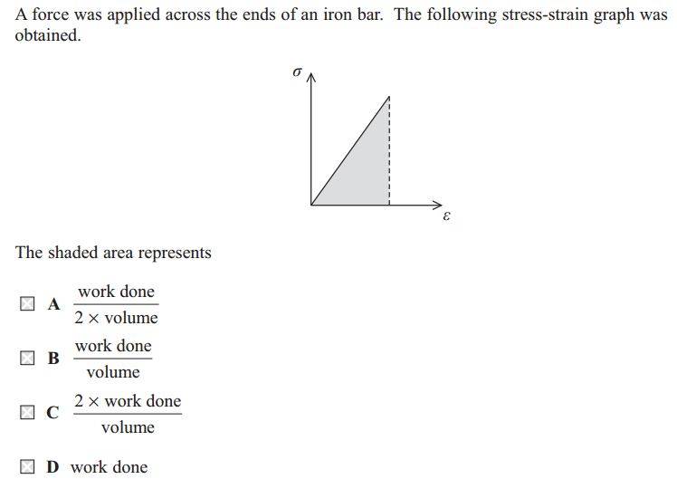

In summary, The work done for a Hookean process is 0.5Fe, where F is the force and e is the displacement. This is obtained by taking the integral of Fde, which gives 0.5Fe. The area of a triangle on a stress-strain graph can also be calculated as 0.5(F/A)(e/L), where F is the force, A is the area, e is the displacement, and L is the length. However, when solving for a specific triangle, the half in the equation should be taken into account.
ravsterphysics
57
The shaded area is a triangle so the area of a triangle for this particular graph is this:
0.5 (Stress)(Strain) which gives:
0.5(F/A)(e/L) so the top would give work done and the bottom would give volume but we're still left with 0.5 in front of this so the answer should be A yet the answer is B? Why has the half disappeared?
The work done is not F*e because F is not constant throughout the process. The work done is the integral of Fde, which for a Hookean process is 0.5Fe
