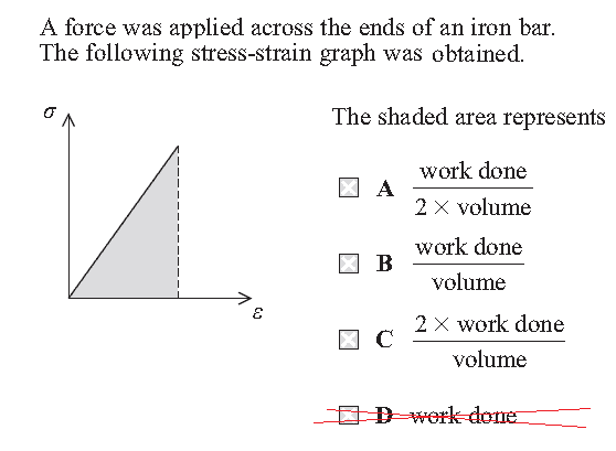

Deducing what the area under the stress-strain curve shows.
There are four option in the attached image. I can discount work done by considering the units. The remaining ones seem plausible, but only one is true.
stress = force / area; strain = proportional extension in length
stress units are N / m2
strain units are unitless
The units of the area could be N / m2 but Nm / m3 units are also consistent. Work done / Volume variants seem plausible.
If the line was y = mx then then area underneath would be (1/2)mx2. Here we have stress = young's modulus . strain.
I would have thought the area under the line is (1/2) young's modulus . strain2. Not sure that helps.

you are correct, look again at the units
Stress = F/A
strain = e/L
stress/strain = (F/A)/(e/L) = FL/eA FL is energy (work done) eA is a 'volume'...so your work done per unit volume makes sense !

Since we're looking at an area under a curve, we should consider the integral ##\int \sigma.d\epsilon ##. Assuming A remains constant, and L being the unstressed length always, how does that turn out in terms of F, A, e and L?

sorry! you are quite right, area = stress x strain = (F/A) x (e/L) = Fe/AL...= work done in stretching/ volume of wire ...you were correct with your 'work done per unit volume'

it becomes Fe/AL
∫ σ dε = ∫ F / A dε
= F ε / A
= F (e / L) / A
= Fe / LA​
Fe is the work done and LA extends the cross-sectional area to the volume. So the area under the line is work done / volume.

Not quite. It is an integral, with σ varying: ∫ σ dε=##\frac {\int F.de}{AL}##, and ∫F.de is work done.
Note that this is valid whatever the shape of the curve. In the diagrammed example, F is proportional to e, so the work done is ½Fmaxemax.

I changed the variable because the work done is related to the distance the force moves. That is given by e directly, and only indirectly by ε.
For both the area under a curve and the work done by a force, the integral is the correct form of the equation. (For work done by force, the completely correct form is the integral of a vector dot product, ##\int \vec F.\vec {dx}##.). You can only simplify to a simple product when the integrand is constant. In the case of a curve, that would be a horizontal line.

I see from the diagram that the area is ½σmaxεmax.
If we assume A,L are constant then we have (1/2AL)(Fmaxemax)
For the work done are we then considering the average force applied is Fmax/2 and so the work done is (Fmax/2).emax?

I have a purist objection to the use of the expression "average force" here, because that is defined to be an average over time, and we are not interested in how long the application of the stress took.
The linear increase of stress with strain shown is exactly like a spring. I assume you are familiar with the formula for stored energy in a spring, 1/2 kx2. The max force is kx, so it's the same result.
Yes I agree about the average force. I'd like to express this as:
Based on the triangle formed on the F-e graph: Work done = ½Fmax.emax
The area on the σ-ε graph will be the same but rescaled. σ will be 1/A of F and ε will be 1/L of e, the area under the σ-ε graph will be the area under the F-e graph divided by AL.
The area under than σ-ε graph = Work done / AL = Work done divided by volume
