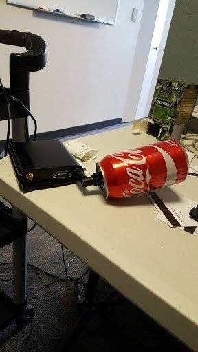

I am testing some 4G netcomm wireless routers to see how much traffic they can handle in certain situations. We are trying to find ways to "impede" them. They have two antennae that can be unscrewed. Removing both pretty much messes them up completely - good to know. Removing one slows things down a bit, but doesn't grind it to a halt.
The best someone came up with at work to test was:
In our meeting I said that I believed this was the old "tin foil hat" thinking. The foil makes it EASIER for the aliens/government to track your thoughts, right? Anyway, in this case, is the can impeding or boosting? What would be a good way to impede the signal?

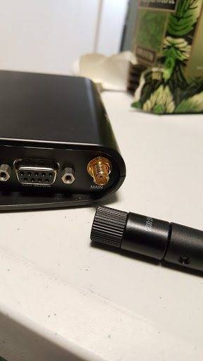

Don't you want something more controlled and repeatable than that? Do those antennae screw on using SMA, or other standard connectors? If so, get a variety of attenuators. You will have a known loss.

In principle; as long as the connector is connected in a pukka way to the circuit board. Even with an attenuator of known value, signal can be radiating any old way from the box. I have heard rumours of all sorts of dodgy practice with router design. Let's face it, some of them are a lot worse than others. They rely on the fact that very few people have the facilities to measure their performance.
True, if the antenna circuit isn't designed/implemented with a fairly close matching impedance, the loss may not be the same as the stated number on the attenuator.
But it should be repeatable on a particular unit, and maybe even across units of the same make/model if their 'dodginess' (is that a word?) is at least consistent. At least far more so than a coke can hung over the antenna!

The only way to test any receiver-plus-antenna is to present it with a signal of known field strength. That would involve quite a lot of trouble because you would need a calibrated source and a detailed knowledge of the whole system. Otoh, it would not be difficult to compare two different receivers.

But to answer your question - well, can you tell me?
Edited to add: if I had actually looked up attenuators than I would have seen that this is probably the right thing, but I'd love if
a) Somebody can verify that from the above photo
b) where/what you recommend on getting.
(Remember, I'm a half-assed mathematician and even less an engineer/electronics guy).

To that - is the coke can impeding or actually helping in some way?

Sorry I keep asking on the same question. So is this just like a coax/cable connector? In which case I could hook up a few of these and put the antenna right back into them? https://www.amazon.com/dp/B01HJNGWYS/?tag=pfamazon01-20
dkotschessaa said:
... is this just like a coax/cable connector?
Yes.
Actually sometimes it happens that the antenna of the router is changed to some directed or special one instead of that puny stick, and in such cases it is exactly used as a coax connector for cable.
However, I'm not sure that it'll be an 50Ohm one. You have to dig that up somewhere.

Unplugging the antenna briefly during operation may be your best bet. The throughput for the weakest signal will likely be hundreds of kilo-bits per second. Your POS systems should not need to sustain anywhere near that even in multiples.
An easy way to do that is get some TNC or RP-TNC adaptors. RP-SMA->TNC--TNC->RPSMA. Make sure the adaptors you get are for the same impedance as the system you have. Likely 50Ohm. Or get the wrong one. That will give you some extra difficulty.
Cut off the female threaded part of the TNC coupler and you have a semi-secure connection that can be cycled fast. TNC is essentially threaded BNC. Use a rotary tool. Diagonal pliers will not cut those easily even though they are brass. Yours may be steel.
