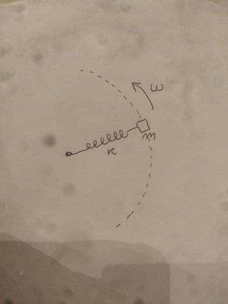

Yesterday I came across this problem:
A mass is attached to a spring and the system rotates (one of the spring end is fixed) in an horizontal plane. Given the mass m, the value of k, the length of the spring l_0 and the angular velocity w, compute the stretching.
I worked out the formula, which turns out to be
##x = \frac{ m \omega^2 \ell_0}{k - m\omega^2}##
(Sorry I don't how to implement latex code)
Now the question: why can't I choose ANY value for w? In principle, the faster the rotation, the longer the stretching... In this case it seems there's a limit for w (which is suspiciously equal to the value of the pulsation for mass-spring). Can someone explain why are these quantities linked?

Can you upload a diagram of the problem? It's a little confusing how a mass in a horizontal plane will stretch a rotating/torsion spring. Use the "Attach files" link below the Edit Window.

Sure, here it is! And thank you for your pm! :)

Yes I did. I set the elastic force equal to the centripetal force.
I agree with your solution as long as ##l_0## is the natural length of the spring.
What happens is that the spring cant provide the necessary force after that breakpoint because the centripetal force grows by ##m\omega^2 x## while the spring force grows only by ##kx## so if ##\omega## becomes too big such that ##m\omega^2>k## there can never be ##m\omega^2x=kx## (it will be ##m\omega^2x>kx##, for any x and of course certainly not the even worst condition ##m\omega^2(l_0+x)=kx##.

I mean [itex] \: \: m(l_{0}+x)\omega ^{2}=(-1)kx[/itex]
There is no difference in the application of Hooke's Law between this situation and a vertical spring with a weight attached.
This is not correct, for x positive, because we know that the centripetal force is in the same direction with the spring force, this equation implies they have opposite directions.
For x negative I think we cannot allow negative x for this problem because then the spring force becomes with outward direction while the centripetal force is always inward.
Duh, I should have also noted the problem with the behavior of x with ω :headbang:
