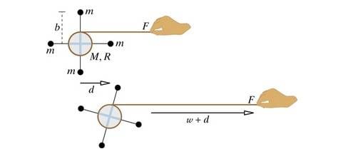

A string is wrapped around a uniform disk of mass M = 1.3 kg and radius R = 0.05 m. (Recall that the moment of inertia of a uniform disk is (1/2)MR2.) Attached to the disk are four low-mass rods of radius b = 0.08 m, each with a small mass m = 0.3 kg at the end. The device is initially at rest on a nearly frictionless surface. Then you pull the string with a constant force F = 33 N. At the instant when the center of the disk has moved a distance d = 0.034 m, a length w = 0.023 m of string has unwound off the disk.
(a) At this instant, what is the speed of the center of the apparatus?
v =
(b) At this instant, what is the angular speed of the apparatus?
omega1 =
(c) You keep pulling with constant force 33 N for an additional 0.039 s. Now what is the angular speed of the apparatus?
omega2 =

Was there no figure accompanying the problem?
There was.
My bad.
The fact that these two numbers are different tells you what?
That the disk is rotating and the system is moving at different rates?
Right. So from those two numbers you can tell how far it's moved (translated) and how many rotations it's made.

Next, repeat that same calculation, but this time you use the rotational motion versions of the linear motion equations.
Mister T said:
Yes! If you remember to attach the units: 0.947 m/s.
d = 1/2 at^2
0.023 = 1/2 (13.2)t^2
0.059032605 = t
omegaf = omegai + RFt / I
omegaf = (0.05)(33)(0.059032605) / 0.009305
omegaf = 10.46789879 rad./s
Okay, does that look correct?
Oribe Yasuna said:
d = 1/2 at^2
0.059032605 = t
Is 13.2 m/s² the linear acceleration of the string? The reason I ask is because 0.023 m is the linear displacement of the string relative to the center of rotation.
No, it's the acceleration of the system of rods and disk.
Would the string's movement be measured in torques?
The string moves a distance of 0.023 m relative to the center of rotation of the disk. What does this tell you about the disk's rotational motion?
