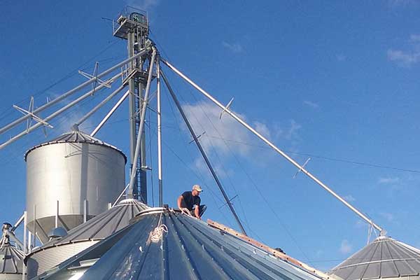

Or carry that one step further, eliminating most of the spindle material.
Structurally, these "grain legs" are spindles, but they use guy wires held by spanners.
Structurally, these "grain legs" are spindles, but they use guy wires held by spanners.View attachment 226766
Your picture made me think of a few things about tubing.
Notice the bin on the bottom left, where corrugated ( galvanized ) curved steel is used for the structure holding the grain.
The "curved ribs" should be increasing the allowable hoop load over that from plane flat curved steel sheets.
In addition, overlap at the bolted joints adds another load boost.
( It would be the same as if the bin was made out of plywood, and rings of steel were added to increase the structural strength from bursting the wood. )
Here we have a boost of the allowable load just from the assembly method.
Pipes of corrugated metal can also withstand exterior pressure forces better than non, such as for culverts stressed under a soil load beneath roadways.
Also, when one wants flexible, corrugated round tubing is the way to go - an example is the bendable plastic straw, which besides being bendable, can also be lengthened ( shortened ) at will. Some pouring spouts utilize this feature for compact storage, along with the bending. While maybe not a strengthening of the tube per se, this does have advantages over the cumbersome telescoping method and the flexible metal tubing method of manufacture.
One strengthening technique for hoses subjected to a negative pressure within is to wrap the hose externally with wire, preventing a collapse of the hose.
One might see that on a rubber radiator hose, at east in the olden days.
