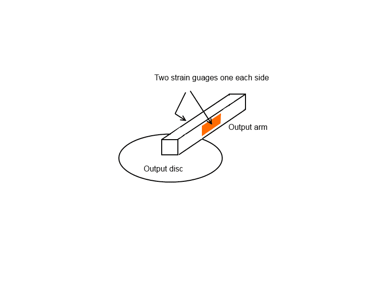

Most strain gauges in effect respond to bending or stretching of the object they are mounted on. One way to measure torque would be to mount strain gauge on the sides of the output arm like this or put them on the servo mounting brackets.

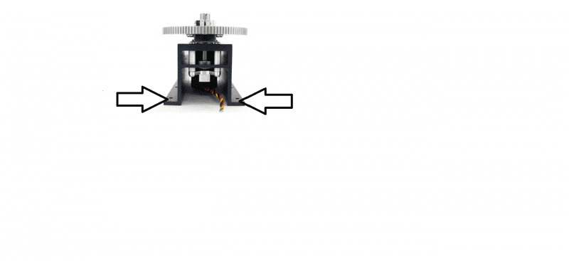

Well I'm a bit confused by your picture. Are you proposing I attach some sort of rod or arm to the shaft of the servo, and then put strain gauges on the sides of that? And by servo mounting brackets, do you mean the areas that the arrows are pointing to in the picture I uploaded? I just want to make sure I'm fully understanding you, and all this terminology is a bit new to me, sorry.
Yes. At least that's if your application needs an arm.
Yes that general area although not exactly position... One way to measure the torque of an electric motor is to measure the equal and opposite torque that the motor casing puts on it's mounting. In this example...
http://www.modelflying.co.uk/news/article/measuring-motor-output/2363
... the author has mounted the motor so the casing can rotate a few degrees (the propeller turns one way and the motor casing tries to turn the other way). He has fixed an arm to the motor casing and arranged for the other end of that arm to press on a set of scales. Torque = force * distance (where force is measured by the scales and the distance is the length of the arm).
I'm not suggesting you do it exactly like that but the principle is the same. Instead of scales you would need to measure the stress in the mounting using a strain gauge. The problem is you can't just stick strain gauges on the servo brackets because they would be in the wrong orientation.
