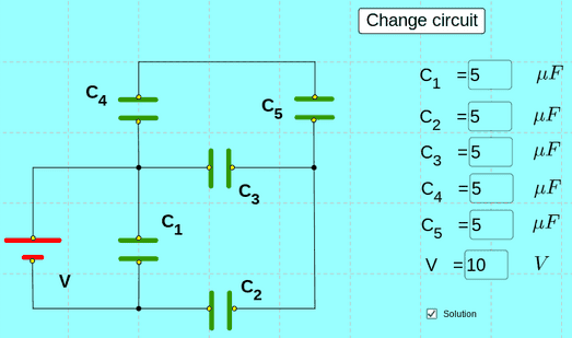

Struggling to find the equivalent capacitance of this circuit

I have attached an image of this circuit. I must:
1. find the equivalent capacitance of the circuit
2. find the charge on each capacitor
3. find the potential drop on each capacitor
equivalent capacitance in series: 1/Cseries = 1/C1 ...
equivalent capacitance in parallel: Cparallel = C1 + C2...
I asserted C3, C4, and C5 to be in series. **I found the capacitance of "C3-4-5" to be 1.67x10-6 F. This I did by using 1/C = 1/C3 + 1/C4 + 1/C5
Then I noticed that I had another series circuit of "C3-4-5" and C1, and C2. Again, I used a similar formula. I obtained an equivalent capacitance of 1.0x10-6 F. This number is not 8x10-6F as told by the answer key.
I have been told that: I am incorrectly interpreting who is in series and who is in parallel. This is frustrating. The common image from any physics textbooks would make it seem that C3, C4, and C5 appear to be in series. Likewise, the common series definition "components directly adjacent to one another" applies to C1, C2, and C3.
I do not understand where my logic is wrong to begin with.

Take two nodes A and B. A set of components are said to be connected in series if the components are joined end to end with no intermediate connections, starting from A and ending at B.
A set of branches is said to be connected in parallel if all of the branches in that set have their endpoints connected to the same two nodes.
Now you are asking why ##C_3, C_4, C_5## are not connected in series. Well, if we start at the bottom left node between ##C_3## and ##C_4## and trace the loop clockwise, we see there is an intermediate connection between ##C_5## and ##C_3##. These three components are thus not in series!
We might say that ##C_4## and ##C_5## are connected in series, and furthermore that ##C_3## is connected in parallel with this previous branch.

Isn't there that same intermediate connection between C4 and C5 (that horizontal)? Therefore, C4 and C5 could not be in series with each other? I am so sorry. This never made sense to me.
You might be getting thrown off by how it looks. Here's an equivalent re-drawing of the circuit between those two nodes:
Can you see that ##C_4## and ##C_5## are connected in series, and ##C_3## is connected in parallel with the above branch?

By "intermediate connection" I mean a junction of some sort, with a branch out to another different part of the circuit. Between ##C_4## and ##C_5## is just a wire.

Thank you for your redrawing. I do see that C4 and C5 are in series. and the intermediate connection C3 experiences with C4 and C5. However, in the original image I posted, this intermediate is just not obvious at all. Starting from the lower left node between C3 and C4, what is that intermediate connection that you see? I can see this in the redraw, but not in the original image.

Equivalently, you can think of it like this: in a series connection between two nodes A and B, there is only one possible path through which the current can flow.

It is very important in circuit analysis to be able to pick out pairs of nodes in a circuit and determine if there are sets of components connected in parallel between those nodes, or if there is a series branch between those nodes, or even if there are multiple series branches themselves connected in parallel between those nodes!
Build up from simpler problems. Really the only way to gain familiarity with circuits is to see and practice with lots of different types of, well, circuits!

Make no mistake, circuit analysis is hard! Determining parallel and series connections is one of the first pieces of the jigsaw puzzle you need to put together. It will click eventually, with practice. Try and not focus on how the circuit is set out on the page, just focus on the ideas of nodes and paths.
Can I trace through this path with my finger between these two start and end nodes, and there are no other (intermediate) connections sprouting off in the middle? Then it's a serial path, also known as a 'daisy-chain' path.
Do these two serial paths have their start and end points at the same nodes? If so, then these two serial paths are connected in parallel!
