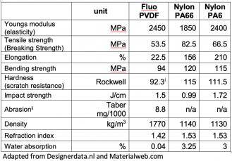

Our experience and 'garage testing' of these lines tell us that fluorocarbon while it can have the same diameter and tensile strength is also what I call 'brittle' - it breaks with shock with a much lower force. Eg
I tested 6lb (0.22mm) Maxima Ultragreen against 6.4lb (0.22mm) Greys Fluorocarbon by hanging 48” lengths of each from my garage ceiling joists and attaching a 1lb weight.
I then dropped the weight fom 47” then inch by inch until the lines broke from the dead drop.
The fluo broke at an average of 3” while the Maxima broke at 14”.
The same test with Sightfree G3 6lb, 0.18mm fluorocarbon broke at 2"
In contrast 6lb 12oz, 0.17mm Reflo Power which advertises itself as resin impregnated mono and is therefore presumably nylon broke at an impressive 9”.

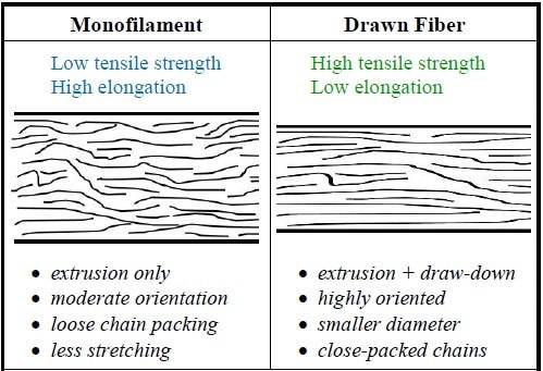

Although you'll often hear it said that fluorocarbon is low-stretch, it's not intrinsically more low-stretch than nylon. Both monos are thinned during manufacture by heating and stretching in a process called drawing. So just as you’ll find both low-diameter nylons and low-diameter fluorocarbon so you’ll find lower stretch versions of each too. Drawing aligns the molecules in the monocreating a stronger line
Understanding Drawn FibersYou don’t get anything for nothing though, so
Speculation: a bi-product of stretching and drawing (ie thinning), may be increasing brittleness.
One of the surprises to me in the table is that base fluorocarbon has a pretty good comparative impact strength (resistance to shock). This seems to fly in the face of experience.

We can see that base fluorocarbon has very low elongation. Elongation is the amount that a material can stretch before breaking. Part of the stretch is elastic - that is the material will return to its original length when the load is removed - part of it is plastic deformation. In deformation the line is permanently lengthened and also weakened. Nylon undergoes stretching in it's elastic phase more or less until it snaps, fluorocarbon deforms quite early in the process of being loaded.
Nylon's high elongation allows it to absorb energy, a useful feature when fighting a fish keen to stress test your line but when it’s drawn, it increases in strength per diameter but decreases in elongation.Speculation: A thin line (in relation to its strength) will probably have lower shock strength than a thicker line because it will have been stretched more. This brittleness may be exacerbated in fluorocarbon because of its inherently low elongation.
So this may be why we hear complaints of fluorocarbon’s breakages in circumstances of sudden shock – catching two fish simultaneously, violent dashes for freedom at short range where there is less elasticity in the whole system of rod, line and leader, excessively hard strikes and so on.

I put together the properties of the material if that helps. I assume that these are bulk material properties that change a lot during drawing

What you have tested through your experiments is how much energy is absorbed by a 48" length of each line before it breaks. This experiment is measuring a property known as "Toughness". The experiment you performed is not good at measuring the "strength" or "ultimate strength" of the line.
