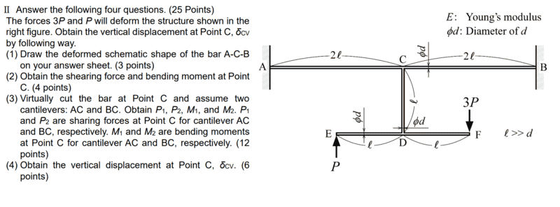

Hello everyone,
I am currently studying for an Mech Eng. Master's Program Entrance exam and am reviewing past test problems from the University website.
Problem statement:
Answer the following four questions (45 min limit):
(1) Draw the deformed schematic shape of the bar A-C-B on your answer sheet. (3 points)
(2) Obtain the shearing force and bending moment at Point C. (4 points)
(3) Virtually cut the bar at Point C and assume two cantilevers: AC and BC. Obtain P1, P2, M1, and M2. P1 and P2 are sharing forces at Point C for cantilever AC and BC, respectively. M1 and M2 are bending moments at Point C for cantilever AC and BC, respectively. (12 points)
(4) Obtain the vertical displacement at Point C, δCV. (6 points)
I am currently stuck on part 3.
I am not allowed any reference material during the exam. This question seems very similar to the process of Slope-Deflection method for indeterminate frames so I believe it may be related.
Diagram of the problem below. I have 45 minutes to finish all parts of this question without reference material.

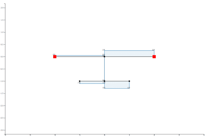

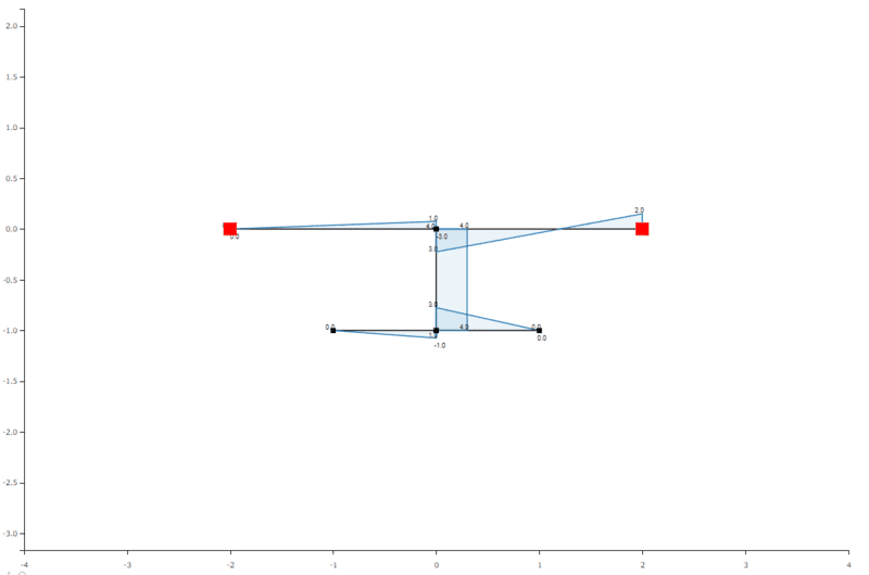

I then verified what the answer should be using the results of 2 frame calculators.
I was able to arrive at the same result as the calculator by using force method but that method is *considerably* too cumbersome to use given the test time and not what is being asked by the problem statement.
