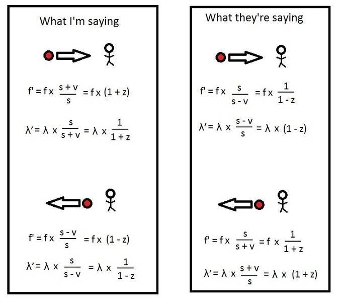

I've made my problem a bit clearer in this picture:
s = the speed of sound v = the velocity of the moving sound source in the direction of the given arrow
With "they" I mean the following sources: https://en.wikipedia.org/wiki/Redshift & http://formulas.tutorvista.com/physics/doppler-shift-formula.html
While this link is supporting my concluded formula for an approaching sound source: https://www.physicsforums.com/threads/prove-that-z-v-c.273160/
See how my formulas differ from them? I don't get why my conclusion is wrong and how "they" have concluded their formulas regardless of these formulas being the same as mine for very small v values.

You are saying that for a source moving towards you, the observed frequency will be given by ##f'= \frac{s + v}{s} f##. This is incorrect. nasu gave you a link to the correct formula and its derivation.
Thanks for your answer. I'm aware that they're different. So what you are saying is that the explanation in post #2 here: https://www.physicsforums.com/threads/prove-that-z-v-c.273160/ is wrong since he's also saying that f' = (s + v) / s)) x f for an approaching sound source? Or did I read the explanation wrong?
You read it wrong. That post is discussing the case of a moving observer, not a moving source:

The formula for a moving source and stationary observer is different from that for a stationary source and moving observer.
I'm amazed.. I didn't know that should be different. Shouldn't an observer observe the same frequency if the sound source approaches him at the same speed as him approaching the sound source instead? I can't seem to wrap my head around on how that should be different.
You need to review how the Doppler formula for sound is derived.
A key thing to realize is that sound waves propagate at some speed ##c## relative to the medium. So it does actually matter whether the sound source is moving relative to the medium or the listener is moving or both.
P. S.: The thread linked by A.T. is worth reviewing.
After reading the links I think I understand now why it's different. The compression of the sound waves is different for when the source is moving compared to when the observer is moving instead.
I made scenarios in which I manually calculated the frequency by looking at the time points an observer would receive every sound wave for both a moving observer or a moving sound source and I get the same results as the formula nasu linked me to.
Thanks a lot for clearing this up guys!
