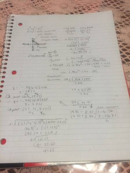

"A small radio transmitter broadcasts in a 25 mile radius. If you drive along a straight line from a city 30 miles north of the transmitter to a second city 33 miles east of the transmitter, during how much of the drive will you pick up a signal from the transmitter?"
x^2+y^2=r^2

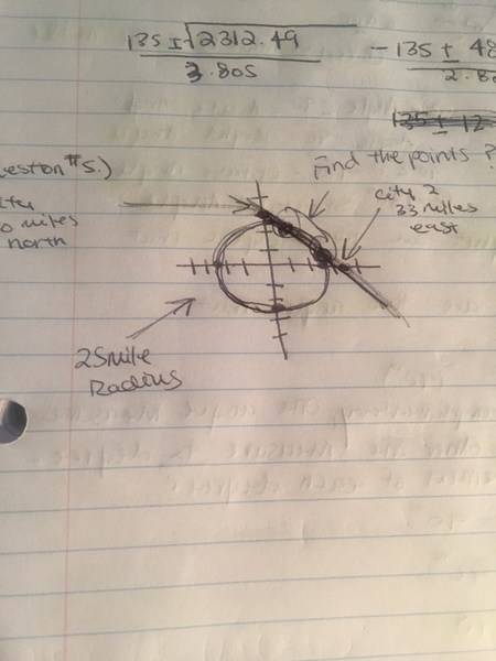

Attempted to the distance of the point that hit the circular radius but I don't know how since there is no points of the city
Yes I have.
Yes, you have to determine the intersections of the route of the car with the circle. How do you do it? What is the equation of the straight line?
The triangle (North,East,Origin) can be fully calculated. From there on you can regard other triangles.
Y=mx+b? b=y-intercept so b=30, and m=slope so 30/35?
If at all then 33, not 35, but I think it's easier with the triangles.
OK, OK, it will make no difference to this problem whether it's East or West. :oldtongue:
Okay guys, I got it. It took me a while to understand the concept because it combined both using the distance formula and the standard form with the quadratic formula!

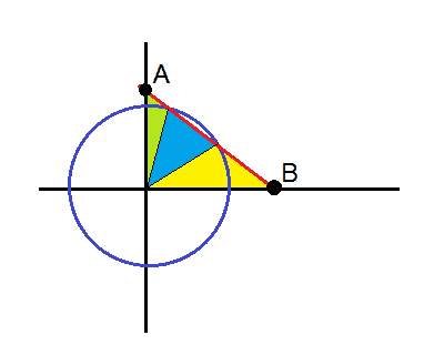

It is correct. There was an other method, using the triangles in the figure below (as fresh_42 suggested) and applying the Law of Sines.

There is a very easy solution, even without trigonometry. The length of the whole path between A and B is ##s=\sqrt{30^2+33^2}##. Using the area of the triangle AOB, 30*33=h*s. Knowing h, apply Pythagoras Theorem to get the length of the chord d: ##d=2 \sqrt {r^2-h^2}##.
Likes NascentOxygen, HRubss and fresh_42
Yes, using similar triangles and elementary circle geometry is the fastest way.
Absolutely whenever you can use similar triangles, use similar triangles!
