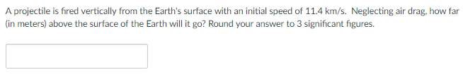

A projectile is fired vertically from the Earth's surface with an initial speed of 11.4 km/s. Neglecting air drag, how far (in meters) above the surface of the Earth will it go?
