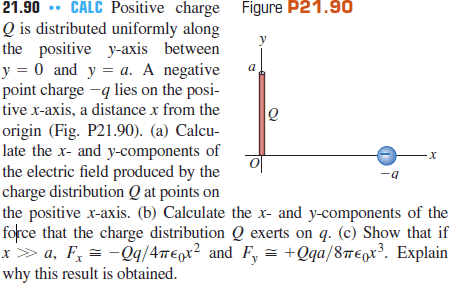

Question:[/B]
____________________________________________________________________________________
And the answer in the solution manual:
Trig sub? [tex]a^2/x^2 = tan(θ) [/tex]
I'm thinking x>>a would affect this majorly and I'm not seeing how.
I understand the concept behind this (I think), but part c is killing me right now. I have no idea how the inverse square root turns into the final equation. Maybe I should have posted this in Calculus, but I have no recollection of learning this in calc I/II, nor physics I/II so I didn't know where to post.
The [tex]a^2/x^2[/tex] looks eerily similar to a trig sub problem, but I don't see how that would work because there's no integral.
For [tex]E_x,[/tex] I was able to set the limit of a to 0 to get the point charge equation. The solution manual didn't do it this way but it worked for me to get the point charge equation.
BTW I already have a) and b), which were pretty straightforward.
Could someone point me in the right direction please? Thank you!
You should double-check that with the definition of the tangent.

Assuming you have the first two parts, you might want to take a look at the Taylor expansion of those answers.

Ah, okay. The format change to (1+x)^(n) is making more sense now... I'm very rusty on infinite series so I'll have to take some time to review. From a brief look at my calc book it looks like it matches the binomial series. Will spend more time to see if it is right. Thanks!
