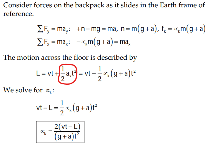

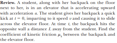

For this problem,
The solution is,
However, is the reason why they don't do ##-0.5a_xt^2## because the negative of the acceleration has already taken care of itself?
Many thanks!
The answer seems to make
a_x=-\alpha_k (g+a)<0
negative. You can make it positve one with your setting of ##-0.5a_xt^2##.
Likes member 731016
Than you for your reply @anuttarasammyak !
Likes anuttarasammyak
