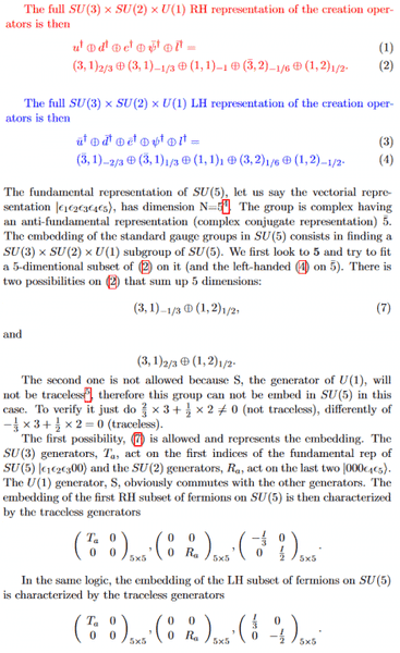

OK. I'll post a screencap of some text regarding unbroken SU(5) and the explicit representation you must be talking about here, and see if I can interpret it...
So, looking at those red equations (1), (2) at the top, that's telling me that, say, the up quark creation operator [itex]u^{\dagger}[/itex] can be 'represented' by [itex](3, 1)_{\tfrac{1}{3}}[/itex]. Straight away I'm confused, because that appears to be talking about [itex]u^{\dagger}[/itex] as though it is an element of a group (since it is assigned a 'representation'). Is this the correct interpretation?
You need to separate the representation from the vector space the representations act on. Many physics texts are not very explicit about this. The point is that a field transforming according to a particular representation under a symmetry is an element of the vector space the representation of the symmetry acts upon. Therefore it transforms in a particular fashion under the symmetry.

Is it correct to say that, in the case of the field [itex]u[/itex], it has three colors, so [itex]u_{r}[/itex], [itex]u_{g}[/itex] and [itex]u_{b}[/itex] would be three different vectors in 'color space'? And the transformations that the SU(3) group is comprised of amount to rotations between these vectors?
Secondly, is there a difference between saying "a particular representation under a symmetry" and "a particular representation of a symmetry group element" ?
Thirdly, I'm supposed to be thinking of these representation matrices acting on the vector space itself rather than vectors living in it? Is this the same sort of idea as the difference between active and passive rotations? (ie. active = transform by altering the vector itself, passive = transform by altering the axes)

Is it correct to say that, in the case of the field uuu, it has three colors, so ururu_{r}, ugugu_{g} and ububu_{b} would be three different vectors in 'color space'?
They are different directions in color space.
Yes, they span a three-dimensional space transforming under the fundamental representation of SU(3). The leptons also transform under SU(3), just according to the trivial representation. The quark flavor space is not "the" space on which the SU(3) acts, it carries a (fundamental) representation of SU(3). Other fields transform according to other representations.
I have trouble parsing what you would mean by the first statement. You represent an (often abstract) group by a homomorphism to a set of linear operators on a vector space. It is unclear what you would mean by "representation under a symmetry".
The representation is the homomorphism to the linear operators on a vector space. You represent a group element by a linear operator, not by a vector.
Or quick and dirty: ##SU(3) \; \; \begin{array} \text{irrep} \\ \longrightarrow \end{array} \; \; GL(V) = \text{linear operations} \text{ (color space )}##.
