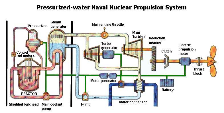

Hi, I was looking at the following diagram and have some questions:
Is the purpose of the pumps to transport liquid of one temperature to another section of the loop?
Is it more efficient to use steam to turn turbine or to use water to turn a turbine? (Is hydroelectric more efficient, but given that the energy output of nuclear reaction is in the form of heat, which can make steam, therefore steam turbine is used?)
What is the function of the Pressurizer? Is it for measuring the pressure to control the control rods and the coolant pump?
- Thanks
The main coolant pump moves coolant in through the reactor. This fluid is radioactive.
The feedwater pump (labeled just pump) moves water from the condenser back to the steam generator. This water is not radioactive.
There is a third pump (dark blue sea water line) that moves coolant through the turbine condenser.
There would be no good way to use water to turn the turbine. What is available as energy is heat from the nuclear reactor. This can be used to boil water and make steam. The rest of the process is a matter of recovering that energy in mechanical form to turn the propeller.
The pressurizer I really cannot address.

Don't think so, mgb_phys. That green line is an electrical connection between the Turbogenerator, the M/G set, the battery, the propulsion motor, and the several pumps, and the pressurizer (whatever that is).
Are you suggesting that there is a small turbogen set inside the pressurizer? That would be highly unlikely simply from a maintenance perspective. That is inside the radioactive boundary and it would be very difficult to maintain and entirely unnecessary to put such their. That would run counter to the entire design philosophy.
No, I thought the green line was pressure to a turbine in the motor generator set.

Back to mgb_phys #5, the M/G set is simply a motor and a generator on a common shaft. This is standard navy terminology. It is often done to convert DC to AC or vice versa.
The pressurizer is what controls the primary system pressure. It is just a tank, about half full of liquid and half steam. This allows the fluid in the primary system to change temperature - as it heats up or cools down it expands or contracts and the pressurizer absorbs this volume change. The liquid in the pressurizer is at saturation conditions so as its level changes and compresses the steam space, some steam will condense and the pressure remains constant (and likewise if the fluid cools and contracts, some of the liquid in the pressurizer will flash to steam). The green line going into the pressurizer in the drawing is an electrical cable, the 'box' inside represents electric immersion heaters that keep the liquid at saturation. The other line going in at the top is a spray line, if the pressure rises too much the sprays will come on to condense steam and lower the pressure. Notice that the spray line is taking water from the 'cold' side of the core. It is probably about 100 F lower than the pressurizer temperature.
Now, one more thing - when I called the pressurizer a 'tank' - don't get the wrong idea, it is a closed vessel made of very thick steel to withstand the pressure. I am not sure about the naval systems, but the systems in the commercial power plants run at 2250 psia, and the pressurizer is at 653 F.
If the M/G set is used to convert DC and AC, does it mean that, on the diagram, half of the green cables are running AC and the other half is running DC? I suppose the half with the battery is DC (?) Why does the M/G Set convert DC to AC to power two pumps, but not the pump that circulates sea water??

You're right - it isn't very clear from this sketch which components run on AC and which are DC. In commercial designs, only small motors (like motors to open & close valves) are DC; everything else is AC. But I guess in a submarine you have different constraints - you have to operate for a time if the reactor trips and the only power available is that from the batteries.
I think you are asking too much of this simple diagram. The green line is electrical -- all of the electrical, AC, DC, high power, low power, -- all of it. This is not a wiring diagram fo the boat.
gmax137, what you said about the pressuizer confirms what I was thinking but was hesitant to say about it. This is essentially the steam drum of a conventional steam plant.
I think that is ture. But the diagram does show some weird details like the clutch and the thrust block. But perhaps there is a reason for the sea water pump to run on DC?

The whole drawing leaves much to be desired. But here is some clarification:
The Turbo generator is actually a Turbine Generator, it supplies AC.
The dark Blue Pump is the Seawater Pump which moves seawater that cools and condenses the steam as goes through the condenser.
The light blue pump represents the condensate pumps and feed pumps. Although theoretically possible to have both be the same pump, it's not practical nor safe.
The motor generator set converts DC stored into the batteries into AC and vice verse. On modern boats these are replaced with solid state alternatives.
The pressurizer as stated before is what maintains primary pressure. Although the plant could be operated solid (with no steam void) it would cause radical pressure changes with the slightest volume or temperature change. The pressurizer allows for changing plant power levels and for the routine addition and removal of primary coolant. It also provides a small volume of water to keep the core filled in the event of a leak.
The thrust block, is better referred to as the thrust bearing. It takes the entire thrust of the propeller and transfers it to the ship.
The Emergency propulsion motor or EPM is DC powered and provides a limited amount of propulsion to the ship. This works in conjunction with the clutch so that the main engine is not rotated with the rest of the propulsion train.
Also please note that this drawing is very basic. It only shows one of each component when many of the components operate in pairs or groups. i.e. there is more than one condensate pump.
