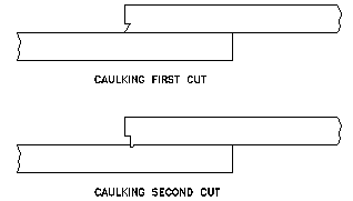

In riveted construction, the edges of two plates are overlapped and joined by one or more rows of rivets running parallel to these edges. In order to seal the riveted joint and make it watertight, a hammer with a special tip is run along the edge of the plate, and one edge of the outer plate is mechanically driven into the top of the adjacent plate, like so:
This is a process known as 'caulking', but unlike waterproofing a window or roof, there is no sealing material (or "caulk") applied to the joint.
As you can imagine, this is a terrifically labor intensive and expensive process, and after the vessel has been subjected to floating and moving about in the water, the caulking can break down and leaks start, so the plate has to be inspected and re-caulked as required. Welded joints eliminate much of this extra work.

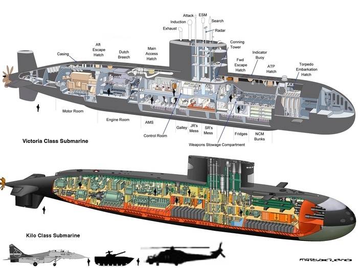

Not everything you see on the exterior of a typical sub is designed to be watertight. The pressure hull is usually stiffened externally with ring girders to save interior space and is not very streamlined. The pressure hull is therefore usually contained within a streamlined outer casing, which is what you see in a photograph of a sub on the surface.
For instance, the sail is usually free-flooding and not manned when the sub is submerged; the control room is contained below the sail inside the pressure hull. Ditto, the control surfaces; they can either flood or there is some sort of material inside to help resist the pressure at depth.
Here are some typical cutaways showing the innards of a submarine:
Indeed, I've been reading up about this (thanks for the links).
Oh that simplifies things a lot! I was under the impression the sail was kept at atmospheric pressure and thus needed to be watertight. The hatch between the sail and pressurized section is at worst case a circular cut-out in a tube under compression (and when the hatch is closed, it can be load bearing too).
