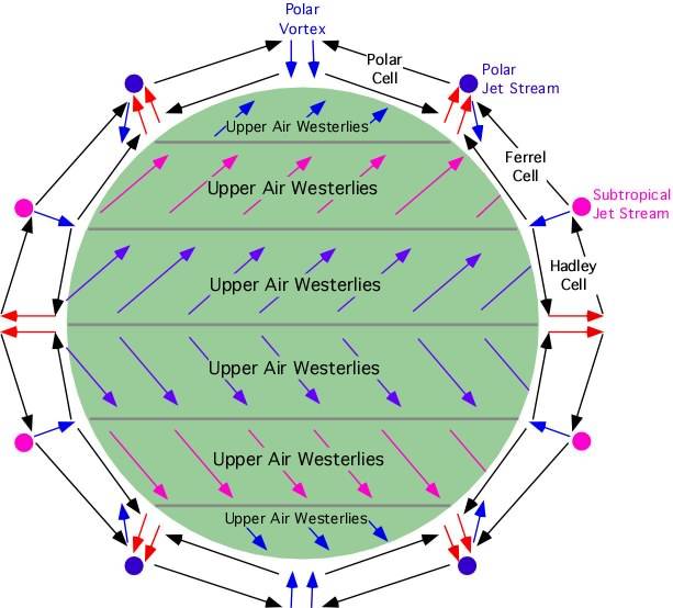

Come to think of it - and correct me if I'm wrong - but your planet has little or no surface structures. That would result in very symmetric undersea currents. The currents wouldn't be deflected by continents as on Earth.
That would likely put some very strong torques on your structure - torques that are reinforced over its entire area.
That's very different dynamic.
These are air currents, but I see no reason why the ocean currents wouldn't follow the same pattern.
Likes Jason K and Drakkith

Yes, I was essentially thinking of Hadley cells as an analogue. Although the density and interaction of a liquid may change the number? But multible atmospheric cells would drive ocean circulation to - I'd guess - at least two layers. These are reinforced by convective currents, between the poles and the equator and between the deep and the surface if there is a temperature and composition difference. But there could be more cells (?) and there could be an oceanic equivalent of the jet stream (?) but I cannot be certain about all that, ocean and atmospheric circulation are not in my field.
Why does the number of (meridional) atmospheric cells drive the number of (vertical) layers in the ocean?
One of the key realizations about ocean circulation is that the atmospheric cells generally do not tend to drive deep convection in the ocean, except in one very atypical but important region. The sun beating down on the surface of the ocean also tends to suppress overturning.
