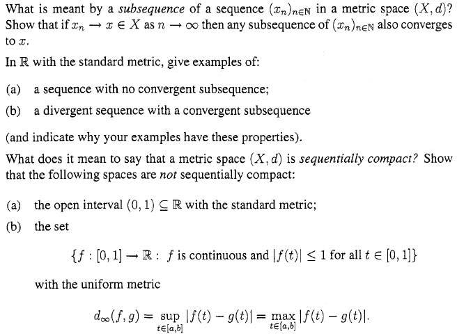

If [itex](x_n)_{n\in\mathbb{N}}[/itex] is a sequence in [itex](X,d)[/itex] and [itex](n_k)_{ k \in \mathbb{N}}[/itex] is a strictly increasing sequence in [itex]\mathbb{N}[/itex] then [itex](x_ {n_k} )_{k \in \mathbb{N}}[/itex] is a subsequence of [itex](x_n)_{n\in\mathbb{N}}[/itex].
How would you prove that if [itex]x_n[/itex] converges to [itex]x[/itex] in [itex]X[/itex] then any subsequence of [itex]x_n[/itex] converges to [itex]x[/itex]?
In (a) how would you justify that the sequence [tex]x_n = n\;\;(n\in\mathbb{N})[/tex] has no convergent subsequence?
For (b) the alternating sequence [tex]0, 1, 0, 1, 0, 1, 0, 1, ...[/tex] diverges but if [itex]n_k = 2k[/itex] then [itex]x_{n_k} = 1[/itex] which trivially converges to 1.
[itex](X,d)[/itex] is sequentially compact if every sequence has a convergent subsequence.
For (a) the open interval [itex](0,1) \subset \mathbb{R}[/itex] is not sequentially compact as, letting [itex]x_n = \frac{1}{n}[/itex] we have that [itex]x_n \to 0[/itex] in [itex]\mathbb{R}[/itex], hence every subsequence converges to 0, but [itex]0\notin (0,1)[/itex] so by uniqueness of limits, no subsequence of [itex]\frac{1}{n}[/itex] converges in [itex](0,1)[/itex], so [itex](0,1)[/itex] is not sequentially compact.
What counterexample could I use for (b)?
What is the definition of [itex]\{ x_n \} [/itex] converging to [itex]x[/itex] in [itex]X[/itex]? And remember [itex](\forall n\in \mathbb{N})\ (\exists n_k \in \mathbb{N}) : n_k\geq n.[/itex]
So since [itex]x_n \to x[/itex], for any [itex]\varepsilon > 0[/itex] there exists [itex]N\in\mathbb{N}[/itex] such that if [itex]n>N[/itex] then [itex]d(x_n , x) < \varepsilon[/itex].
But for all [itex]n\in\mathbb{N}[/itex] there exists [itex]n_k \in\mathbb{N}[/itex] with [itex]n_k > n[/itex] (Archimedes - [itex]\mathbb{N}[/itex] is unbounded above).
But then for any [itex]\varepsilon > 0[/itex] there exists [itex]N\in\mathbb{N}[/itex] such that if [itex]n_k > n >N[/itex] then [itex]d(x_{n_k} , x) < \varepsilon[/itex] showing [itex]x_{n_k} \to x[/itex].
How would you give brief justification that the sequence [itex]x_n = n\in\mathbb{N}[/itex] cannot have a convergent subsequence? (it's divergent but (b) shows that you can have a divergent sequence with a convergent subsequence.)
I suppose you would prove it by the same reasoning as you'd prove that the sequence [itex]\{n\}_{n\in \mathbb{N}}[/itex] diverges, reductio ad absurdum using the definition of convergence to get a contradiction.
For the last problem, try to find a sequence of continuous functions that converges to a non-continuous function. I have one in mind, but haven't thought of the details yet. Consider piecewise functions...

I now realize I was confusing myself--I was trying to prove that the subspace is not complete, when I should be thinking about sequential compactness. That is, we need to find a sequence that has no convergent subsequence. And as Ted mentioned above, this sequence needs to be divergent since if it is convergent then every subsequence will converge to the original limit.
So now I do think my example works. I haven't proved it, but given ##n_0##, I'm fairly certain it's possible to choose ##m,n \geq n_0## such that ##d_\infty(x^m,x^n) > 1/2##. One just has to pick m much larger than n so that ##|x^m - x^n|## approaches 1 near x=1. I think one can show similarly that the sequence has no convergent subsequence.
