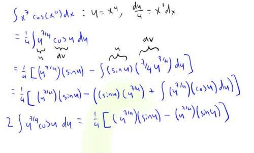

First make a substitution and then use integration by parts to evaluate the integral.
∫x[itex]^{7}[/itex]cos(x[itex]^{4}[/itex])dx
Equation for Substitution: ∫f(g(x))g'(x)dx = ∫f(u)du
Equation for Integration by Parts: ∫udv = uv - ∫vdu
So here's my attempted solution
I made a substitution and tried using integration by parts twice but I got stuck on the last line since it turns out to be zero... I know I went wrong somewhere but I can't seem to find my mistake. Any help would be really appreciated! Thanks :)
The second line is incorrect - when you made the u substitution you did not use your expression for dx in terms of du.
Likes 1 person
Start by writing the integral as [itex]\int x^4cos(x^4)(x^3dx)[/itex] and it is clearer.
Likes 1 person
I see my mistake now! Thanks for the help :)
