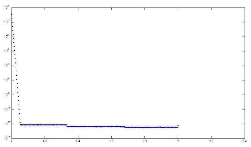

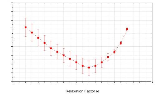

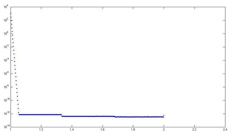

I've made the necessary changes.
However, the results are still the same.
I'm plotting 'omega' versus 'logError'. I'm unable to find wopt(optimum) from the graph.
The blue-lined graph below shows my results.
The red-lined graph is the desired output.

I can't comment much because I am not familiar with the method you are using. But looking at your graph, the values are in the range 104 to 10-12. That's 16 orders of magnitude, which is basically equal to the machine epsilon for a double precision real.
This might be a case where you can't do any better because you are running out of decimal places.
Likes Aun Muhammad
What you are suggesting seems plausible.
The results however must display a general trend similar to the desired result. The Error must decrease, reach a minima and then begin to increase again. Sadly that is not true in my case.

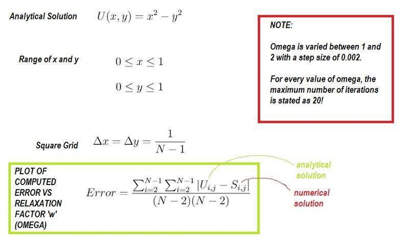

2) According to your formula you should divide by (N-2)*(N-2), but I cannot see that it is done in the code.

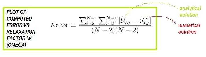

I've changed the value from single to double precision as you stated. But could you please reiterate what the formula attached below actually means?
In my understanding,
Omega, or w, is being varied from 1 to 2 with a step-size of 0.002. This makes 501 iterations.
For every value of w, I'm carrying out 20 iterations for the calculation of UNEW.
Within these 20 iterations, i and j are varied from 2 to N-1 for the whole grid.
I'm trying to calculate the value of error for every value of w. Therefore, the sum of errors for the 20 iterations has to be summed up right?

Hey, sorry for the delay of my reply. No, in my understanding the formula isn't saying that.
Written out it is ##\mathrm{Error} = \frac{\sum_{ij}|U_{i,j}-S_{i,j}|}{(N-2)*(N-2))}##, where ##U## is the exact solution and ##V## is the approximate one.
In other words, for a fixed number of iterations, the error is computed as the average error over the considered mesh in ##x## and ##y##.
Typically, you should therefore compute the error after in your case 20 iterations. If you want to check convergence with respect to the number of iterations, you keep #w# fixed and compare the errors for let's say 19 and 20 iterations. However, in none of the cases you sum up the the errors.
If you do so, the total error will be dominated by the error coming from the first iterations (where errors are large).
