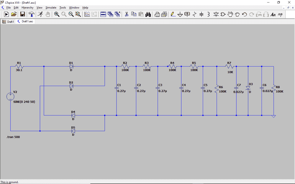

This is the circuit I have designed. Although we have no personal advisors, I did get verified from one of our professor. He allowed me to proceed and informed me to use components with high power dissipation.
The above circuit is followed by voltage divider circuit made using a potentiometer.
The above circuit is all soldered on a printed circuit board. The circuit is practically ready but I have not tested it yet :(

Yikes. Aside from D3 appearing to be installed backwards, that circuit has several safety issues, including presenting a shock hazard to folks who come close to it.
Is there an Earth Ground available in your AC Mains connection? I'm not familiar with the AC Mains distribution in your country.
Also, is there a reason that you did not use a safety-approved power transformer to step down the AC Mains voltage? What are the voltage and current specifications for your final circuit? (Although I guess that depends on what you end up with for your final detector circuit).

@berkeman. Sorry for late response. I was in college when I read your reply.
On the D3 being connected backwards, I actually bought a readymade rectifier circuit. And it is working properly.
On the Earth Ground, yes I have connected a 3 terminal plug.
I could not use a safety approved power transformer because I couldn't find a step down transformer which would convert 240V to 80V. I am using all components of atleast 1 watt power dissipation. So I don't think component burning is going to be an issue

So you are saying that you used a pre-built module for the circuit schematic that you posted, so the upside-down Zener diode is not actually in the circuit module that you are using? Because it sure looks like that Zener is in upside-down, and will short out the "80V" output...
That circuit is a shock hazard without an isolating transformer and a grounded metal enclosure (Quiz Question -- Why?).
And it needs to have a fuse and switch connecting its input to the AC Mains. If this circuit hurts anybody or catches fire, you and your school will likely be liable.
Please see if there is anybody at your school that can Mentor you in how to build AC Mains-based projects like this. Thank you.

Also, for added safety, you could use your present circuit with a 1:1 isolation transformer; or a stepdown transformer to any voltage above above 60V by decreasing the series resistors R2,3,4,5 and maybe R7.
Your LTspice; V2 ≡ SINE( 0 240 50); will generate a sinewave with a peak amplitude of ±240 V.
But the 240 Vrms supply has a peak voltage of 240 * √2 = ±339.4 V relative to neutral = ground.
So you need to specify; SINE( 0 339.4 50) to simulate the real or ideal supply voltage.
