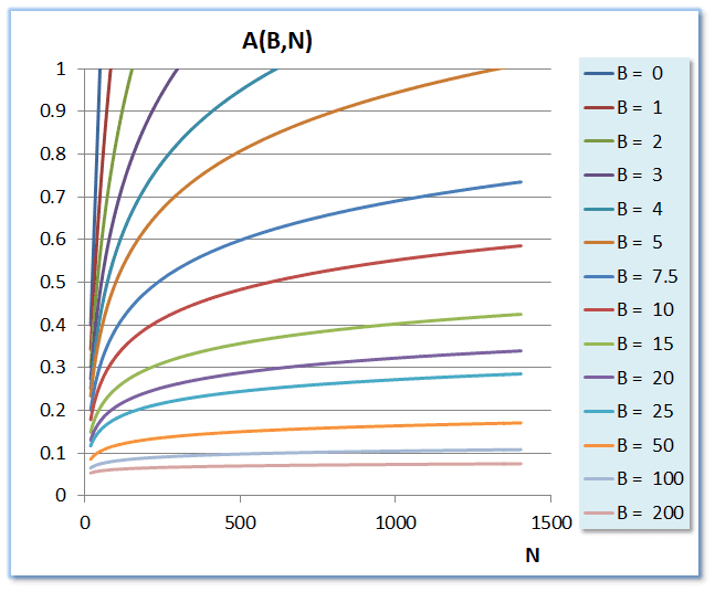

Here is my summation:
[itex]sum(1/(25+n*B)),n=0 to (N/2)-1:=A[/itex]
where A is between .01 to 2, N is between 10 to 2000 and I need to find the B for different values of N. I calculate this summation online (check here)
But the Digamma function makes the output function complex and it is not easy to solve with a calculator or even by hand. I need to calculate the result of this summation with hand easily. Is there any way to convert my summation to simple formula? something like this

So am I right in assuming you want to find B(N, A) satisfying$$
{\psi^{(0)}\Bigl ({N\over 2} + {25\over B}\Bigr ) -
\psi^{(0)} \Bigl ( {25\over B}\Bigr )\over B }= A
$$where N = 10 ... 20000 and A = 0.01 ... 2 ##\qquad ## ?
Well, then you have a problem ! You could make a table and write it on your hand, but if you don't have very big hands it will be hard to read.
Any chance of a compromise ? Can you compute the table and do a fit to a suitable function ? What accuracy is required ?

Yes, I need to find B based on the given variables values. what is the simplest function of digamma to solve with the small computers ( I need to run a simple program on an embedded computer which has a 1Mhz CPU(Yes 1Mhz not 1Gihz), the result should be real not a complex value.
You still have a problem. And (for me) an undetermined problem: if you can allow 20% inaccuracy it's a different problem than if you need double precision accuracy.
I would try to evaluate/solve on a real computer and then fit a suitable approximating function that can be ported to the embedded device.
The result is real because all terms in the sums are real, right ?
You don't even need the digamma: just run the summation for N = 10 ... 20000 and do a hit and miss (or something better) on B. Keep the B(N,A) that have A in the right range. Once you have enough points, search for an approximating function with Tablecurve or similar.
An exploring excursion with excel can get you started for the first step:
[edit] checking :wink: -- after 'discovering' that ##\ A < 0.04 \ ## does not solve, no matter which B and N :biggrin:
I didn't try any fitting yet (don't have Tablecurve).
