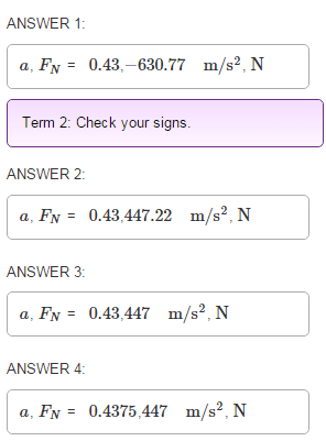

But leaving it as negative gives me the incorrect answer?
F_N = F_g + F_py = 539N + 160 * sin(325)
F_N = 539N - 91.77N = ~447N (incorrect)
F_N = F_g + F_py = 539N + 160 * sin(325 + 180)
F_N = 539N + 91.77N = ~631N(correct)
