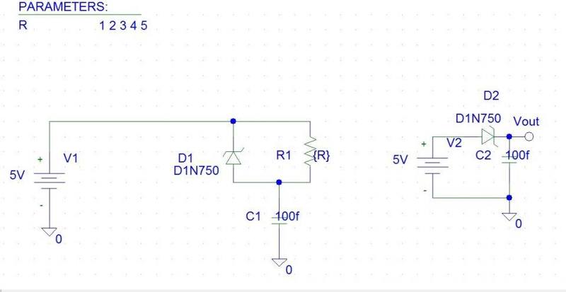

Hello,
I am designing a phone charger with super capacitor with capacitance C=100F. The max voltage of cap is 2.7 V. When I charge the capacitance and then charge my phone, it is charging really slowly with low current (around 700mA). However, as I read, capacitance should output high current. The other thing is, when I charge my capacitor while phone is connected to it, it is charging itself then charging my phone slowly. Please let me know how I can make my cap output more current to charge my phone. The schematics are below. I used both . Please share your experience and give advice.

No, not at all. A capacitor in an open circuit output no current at all. A cap in a high impedance circuit outputs very little current. A cap in a very low impedance circuit outputs high current (briefly).

When I said low ESR, i compared them to batteries so caps outputs higher current. Please give a feedback the circuit I am using to charge my supercap.
Ok, the circuit you are using to charge the cap will destroy it. There is nothing to prevent the voltage from exceeding 2.7 volts when being charged from a 5 volt source.
Oh sorry, I forgot to mention that I am using two of caps connected in parallel. SO they form 5.4V together.

Probably best to draw it that way then. And do you have anything to guarantee that they will charge equally? What is the spec on the caps for tolerance? If their capacitances differ then one will charge to a higher voltage than the other.

That's probably not a good idea. As ASN points out, there are symmetry issues with it, and the way you usually handle that is with resistors in parallel around the caps, which robs charge and power in the overall circuit. Do they not make supercaps with a rating > 5V?

A separate issue to consider: when you power anything from a capacitor that was initially charged to 5V, after the capacitor has given up just 10% of its charge then its voltage will have dropped by 10%. So, I'm wondering is 4.5V still going to be any good for charging a phone?

4.5V is giving out about 800ma to charge but it is varying (going down). But I think when the current is over 600ma ,the phone can be charged
An interesting thing to note is that you were planning on putting higher value caps in series. And you avoided the higher voltage caps because they had smaller capacitances. Do you know what happens to total capacitance when capacitors are placed in series?
