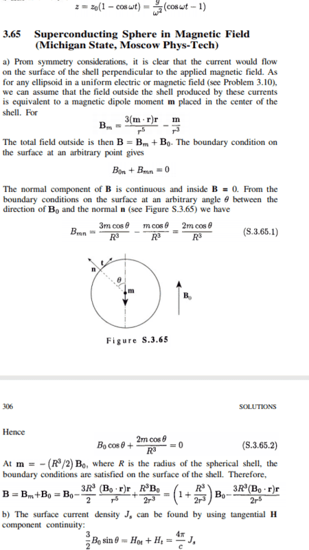

A superconducting spherical shell of radius R is placed in a uniform magnetic field ##\vec{B_0}##
1)Find the magnetic field everywhere outside the shell
2)the sutface current density
Inside the shell the net magnetic field is 0, and at the surface also.
The magnetic field of a magnetic diople of moment ##\vec{m}## is
$$\vec{B_m}=\frac{μ_0}{4\pi}[\frac{3(\vec{m}.\vec{r})\vec{r}}{r^5} - \frac{\vec{m}}{r^3}]$$
The boundary condition at the surface which is at an angle ##\theta## with the vertical is
$$\vec{B_{0,\hat{n}}}+\vec{B_{m,\hat{n}}}=0$$
So,$$B_0\cos{\theta}+\frac{μ_0}{4\pi}(\frac{2m\cos{\theta}}{R^3} )=0$$
Therefore at $$\vec{m}=-(\frac{2\pi}{μ_0})R^3 \vec{B_0} $$,the boundary condition are satisfied on the surface of the shell.Hence,$$\vec{B}=\vec{B_0}-\frac{(3R^3)(\vec{B_0}.\vec{r})\vec{r}}{2r^5} + \vec{B_0}(\frac{R^3}{2r^3})$$
But i can't find the surface current density in this way. In my textbook,the author has written that we can find that using tangential B's continuity though i didn't get that.
You calculated m as function of B and then plugged in m as function of B again (and I'm a bit surprised the terms don't cancel). You need m as function of the rotation of the surface current.
I know that way,but it is also a valid process i think.
You can see page 305 of "A Guide to Physics Problems" by Cahn and Nadgorny
Here it is
