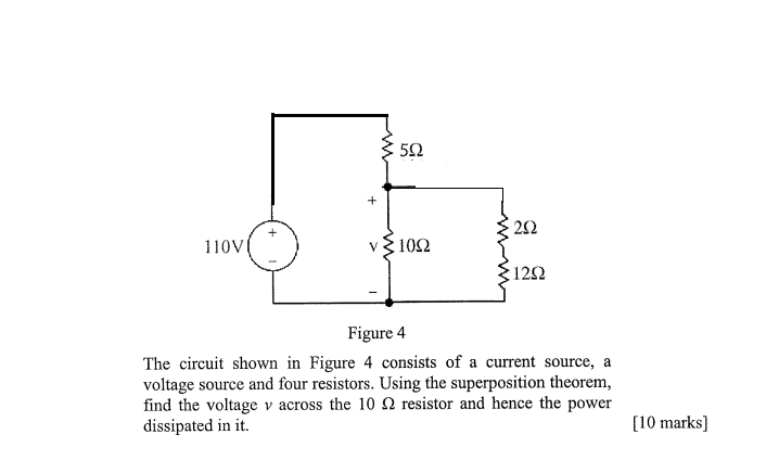

Hi, could check if I have the right answer please. The question (Q 4b) is in the attached image below.
My answer is:First for analysis the DC voltage source.
i2 = 0.82A, i1 = 1.97A
therefore V across 10Ω resistor = 11.5V.
For the analysis of the current source I got a bit confused, however, I think I might have got it right. I shorted the voltage source and found the current across the 50Ω resistor by doing:
Rt= (10//2) + 12 = (41/3)
i50Ω = (Rt*is)/(Rt+50Ω) = 0.86A
Then to find the current across the 10Ω resistor:
Rt = 2Ω hence i10Ω = (2*0.86)/(2+10) = 0.14A.
Thus V10Ω = 1.4V.
Then adding the two separate source responses across the 10Ω resistor the total voltage V10Ω= 1.4 + 11.5 = 12.9V.
Is this correct? :confused:

There is no 50 ohm resistor.
First thing is to label the resistors and sources. Put in numbers only at the very end.

Woops lol.I'll try again.
First if we remove current source we have a simply voltage divider:
Vx1 = 110V * (10||14)/(5 + 10||14)
Next we connect a current source but we short a 110 voltage source we have a very simple current divider.
http://en.wikipedia.org/wiki/Current_divider

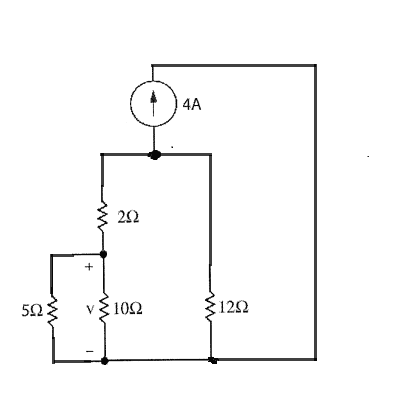

The circuit divider doesn't seem that simple to me. ?

Jony130 said:
First we have a voltage divider
http://en.wikipedia.org/wiki/Voltage_divider#Resistive_divider
Vout = Vin * R2/(R1 + R2)
So in our case
R2 = 10Ω||14Ω; And R1 = 5Ω; Vin = 110V;
Next we have a two current dividers
The current that is flow through 2Ω resistor is equal to:
I = -4A * 12Ω/(12Ω + (2Ω + 5Ω||10Ω) = -2.76923076A
And 10Ω resistor current is equal to ??
Ix = -2.77A * ??/( ?? + ?? ) = ??
Thanks that's excellent, but how do you know to make the equivalent circuit like that? I was trying to draw it with the 4Amp going into the circuit splitting between the 5ohm resistor and the other branch.
Hey what can I say, I simply look at the circuit and I see equivalent circuit after some thought.
So all you need is some experience, that's all.
