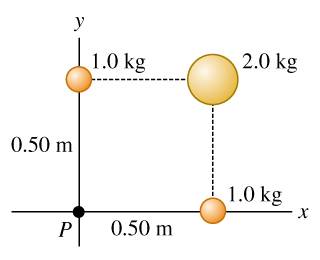

Three uniform spheres are fixed at positions shown in the figure.
i) What is the magnitude of the force on a 0.0150-kg particle placed at P?
ii) What is the direction of this force?
iii) If the spheres are in deep outer space and a 0.0150-kg particle is released from rest 300 m from the origin along a line 45∘ below the -x-axis, what will the particle's speed be when it reaches the origin?
Fg = -GMm/r2
I think I've got the answers for part i) F = 9.67×10-12 N
ii) 45°.
I got i) by simply working out the force due to gravity on P due to each of the spheres and then resolving them to see the component of the force along the 45° angle.
However part iii) I'm struggling with. Obviously the force will increase as P gets closer to the origin. This will mean that the acceleration will increase.
I think Fg ∝ 1/r2 and the acceleration a = Fg/m.
Because the acceleration is non constant I think I have to integrate a with respect to t to find v. However there is no mention of t anywhere in this question! From here I'm not quite sure where to go and any help would be greatly appreciated!

Do you mean U = -GMm/r Tsny? Could I work out the potential energy at the distance of 300m and then using conservation of energy set it equal to U + KE of the origin?
How would I simplify the masses into 1 mass? I can see that it would be on the 45° line connecting the 2kg mass and the origin but not sure how I could work out the mass and exact location. We have done this in class but I'm struggling to make sense of both my notes and the textbook!
That's the formula for U that I was suggesting. Yes, you can use conservation of energy.
300 m is so far away that you can just lump together the three spheres and think of the lumped mass as located at the origin. This will be accurate enough since your data has at most 3 significant figures. In fact, you could probably consider 300 m as "infinitely far" and still get a good answer.
But, of course, you cannot lump together the three masses of the spheres when the particle is at the origin.
I think you can find COM of the three masses. Then you can find the energy(KE) to take the particle away from origin to 300m away, using integral here since force not constant

Thank you for all of your responses! I understand how to use conservation of energy but am still a bit confused over how to
. As far as I can see only a component of the 1kg would act as the other component would cancel each other out (although mass isn't a vector force so maybe I'm just getting myself very muddled!) How would I work out what the mass at the origin would be?
When the particle is 300 m away from the origin, the potential energy between the particle and the three spheres is going to be very small. I suspect that you are meant to treat 300 m as essentially the same as "infinitely far away".
However, if you don't want to totally neglect the potential energy at 300 m away, you may consider all three spheres as being combined as one total mass of 4 kg located at the origin. The error that results from this simplification is very small because the distance of 300 m is so much larger than the roughly 1 meter separation between the spheres.
I think you will find that treating 300 m as "infinitely far" will give you an answer for the particle's speed at the origin that is accurate to at least three significant figures.
[Potential energy is not a vector quantity, so it doesn't have components that cancel out.]
Likes struggles
Thank you so much! I have finally managed to arrive at the correct answer.
