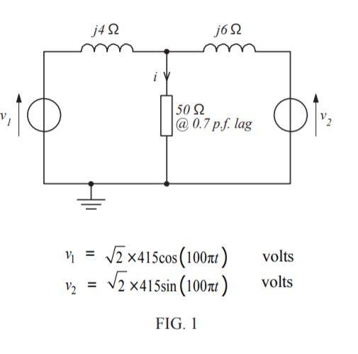

Figure 1 shows a 50 Ω load being fed from two voltage sources via their associated reactances. Determine the current i flowing in the load by:
(a) Thevenin's theorem
(b) Superposition
(c) Transforming the two voltage sources and their associated reactances into current sources( and thus forming a pair of Norton genorators
V1 = √2 x 415cos(100pit) ∴ 415∠90 RMS
∴ j415 as cos leads sin by 90 degress.
V2 = √2 x 415sin(100pit) ∴ 415∠0 RMS
∴ 415
ZL = 50Ω @ 0.7 P.F ... convert into polar
sin-1 0.7 = 45.573 degrees
∴ 50∠45.573 convert into rectangular.
∴ 34.999+j35.7072. Homework Equations

My problem is my superposition is not correct and I cannot see where my mistake is.
I'm confident that my Thevenin's is correct. 5.714+j0.892A or 5.783∠8.872 Deg's as I also have this as my answer using Nortons.

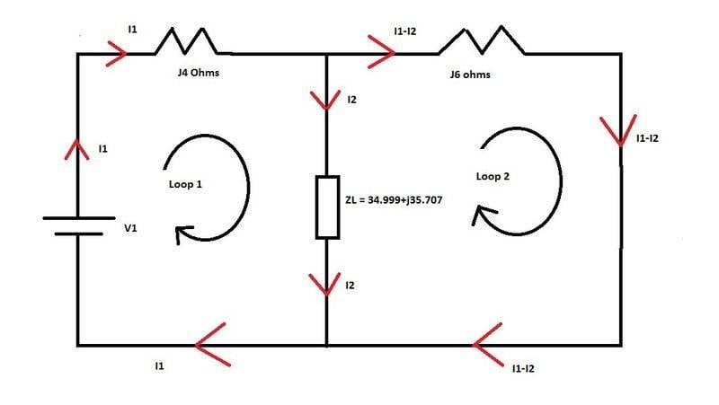

What component of load current do you attribute to source v1? Your numerical value.
And to v2?

This isn't right. Even after you fix the missing parentheses I think it still won't be right. Mark on your diagram the complete path followed by currents I1 and I2.
Look at your first equation. The current I1 only multiplies j4, but I1 also flows through the load so there should be a term where I1 multiplies the load impedance. Also, why is the term where I1 multiplies j4 negative?
Thanks guys. OK, so here is how I have distributed my currents for voltage source 1. As I move from the top of V1 for loop 1 the first component I encounter is the j4 ohm impedance. As this is with the current flow it would cause a voltage drop so my first component is -j4I1. The next component I encounter is the Load impedance which as it is with the current flow causes a voltage drop so this should give me -34.999+j35.707I2. The next component in the circuit is the voltage source. As this goes from negative to positive this would give me a voltage rise of +j415.
This gives me -j4(I1) -34.999+j35.707(I2) + j415= 0
-j4(I1) - 34.999+35.707(I2) = -j415 Loop 1 equation
For Loop 2 I start at the left hand side of the j6 ohm impedance and as it is with the current flow it would be a voltage drop which gives me -j6(I1-I2). Then following it round to the load impedance I am against the current flow which would give me a voltage rise which gives me +34.999+j35.707 so my loop 2 equation should read -6(I1-I2) +34.999+35.707(I2)
-6(I1) +6(I2) + 34.999+35.707 ...now add the I2's
-6(I1) +34.999+41.707(I2) = 0 Loop 2 equation
Final Loops for V1
-4(I1) - 34.999+35.707(I2) = -j415 eq 1
-6(I1) + 34.999+41.707(I2) = 0 eq 2
Your first equation (and in the second it wouldn't hurt) needs some parentheses like this:
-4(I1) - (34.999+35.707)(I2) = -j415 eq 1
And you've totally lost your imaginary constant j where needed:
-j4(I1) - (34.999+j35.707)(I2) = -j415 eq 1
-j6(I1) + (34.999+j41.707)(I2) = 0 eq 2
What do you get if you solve these?

pgetts said:
O.k so using Cramer's Rule.Δ = -j4(I1)x(34.999+j41.707)(I2) - (-j6)(I1)x(-34.999-j35.707)(I2) = ?
ΔI1 = (-j415)x(34.999+j41.707)(I2) - (0) x (-34.999-j35.707)(I2) = ?
You have sign errors involving the same quantity where you made the parentheses mistake (corrections in red). Try the calculations again.
Δ = -j4(I1)x(34.999+j41.707)(I2) - (-j6)(I1)x(-34.999-j35.707)(I2) = (381.07-j349.99)
ΔI1 = (-j415)x(34.999+j41.707)(I2) - (0) x (-34.999-j35.707)(I2) = (17308.4-j14524.6)
ΔI2 = (-j4)(I1)x(0) - (-j6)(I1) x (-j416) = (2490)
I1 = (17308.4-j14524.6)/ (381.07-j349.99) = (3.963+j3.639)
I2 = (2490)/ (381.07-j349.99) = (3.544+j3.255)
Thanks guy's I've got the right answer now. Simple mistake of not adjusting the sign on the j constant as I dropped a voltage across the impedance.
I1 = (17308.4-j14524.6)/ (381.07-j349.99) = (3.963+j3.639) should be (43.627 + j1.953)
Even though I1 doesn't figure into the final calculation of the current through the load, you've made a mistake in calculating its value.
Thanks. Yes must make sure that what I input into my calculator is correct. So just to confirm that with an impedance in the form of (a+bi), as the current crosses the impedance this would cause the voltage drop and both the real and imaginary parts sign to change i.e (-a-bi)
