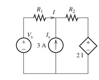

Assume that Vs = 10V , R1 = 1.7Ω , and R2 = 0.50Ω. Find the current I in the figure using the superposition principle.
Superposition principle
KCL, KVL
V=IR
Current and voltage dividers
I = I' + I''

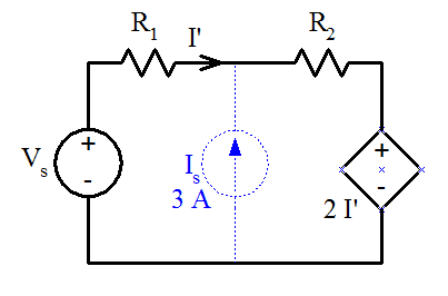

First replacing the current source with an open circuit, I have:
(1.7+0.50)*I' = 10 - 2I' using KVL
Solving, I' = 2.38 A
Now replacing the voltage source with a short, I use the current divider to get:
-I'' = 3*0.5/(1.7+0.5) = 0.682 A
I'' = -0.682 A
I = 2.38 - 0.682 = 1.7 A, which is incorrect.
EDIT: Should I have left the dependent source as 2I and solved for I in the final equation, or am I doing something else wrong?
EDIT2: Yes, I did have to leave it as 2I. Got it :)

1) Suppressing the current source:
We are left with a single series circuit (blue dotted components are suppressed/removed):
Writing Ohm's Law for the circuit we have
## I' = \frac{V_s - 2 I'}{R_1 + R_2} ##
## I' = \frac{V_s}{R1 + R2 + 2}~~ ## after solving for I'
## I' = 2.381~Amps##

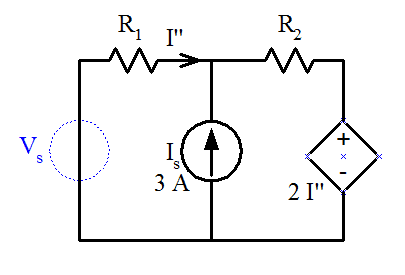

2) Suppressing the voltage source leaves us with:
Let v be the voltage at the junction of the resistors. Then writing a node equation there:
##\frac{v}{R_1} - I_s + \frac{v - 2 I''}{R_2} = 0##
But Ohm's Law also gives us ##v = -I'' R_1##. So substituting for v in the node equation:
## -I - I_s + \frac{(-I'' R_1 - 2 I'')}{R_2} = 0##
##I'' = -I_s \frac{R_2}{R_1 + R_2 + 2} ##
##I'' = -0.357~Amps##
3) Combining the results:
##I = I' + I'' = 2.024~Amps##
Quick Check:
##V_s - I R_1 = (I + I_s) R_2 + 2 I##
##I = \frac{V_s - I_s R_2}{R1 + R_2 + 2} = 2.024~ Amps##
